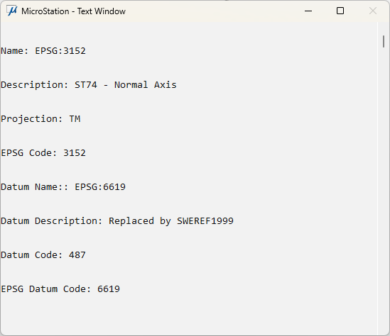

Run/Execute project
Select project “GCSInfo.py” from the Python Editor dialog and Run/Execute the python script.
If GCS, is attached to the model, “MicroStation - Text Window” displays GCS properties like name, description, projection, EPSG code, datum information, and EPSG datum code.
