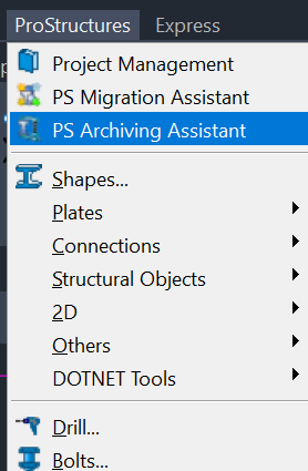

Before uninstalling the former version, please make a copy of the complete folder  Drive:\Program Files\Bentley\ProStructures CONNECT for AutoCAD\AutoCAD 2019 or -20. or use the archiving assistant.
Carry out the archiving procedures to generate the archive. Next, install the latest version and employ the migration assistant on either the folder containing the copy of the old version or the archive (psa) file. Finally, perform the migration steps.
