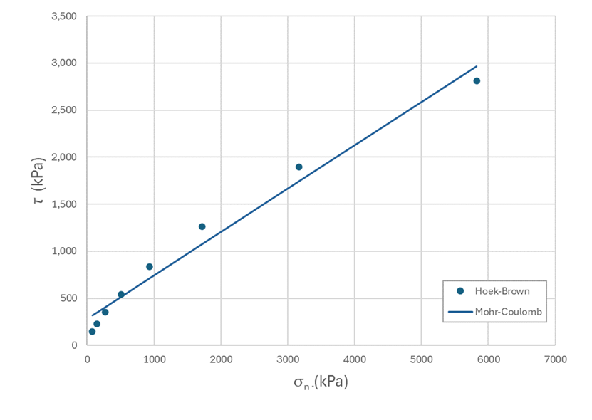

The rock mass is a graphitic phyllite with a uniaxial compressive strength of σci = 15 MPa. The rock mass is described as 'disintegrated', consisting of a poorly interlocked mixture of angular and rounded pieces, and 'poor' with slickensides and highly weathered surfaces corresponding to an approximate Geological Strength Index GSI = 25. The uniaxial compressive strength of the rock mass is estimated as σcm = 1 MPa (deducted from the equivalent cohesive strength ceq = 330 kPa and equivalent friction angle φeq = 24.9&deg obtained by curve fitting as shown in Figure 1.
Figure 1: Converting Hoek-Brown Strength Envelope to Mohr Coulomb failure line

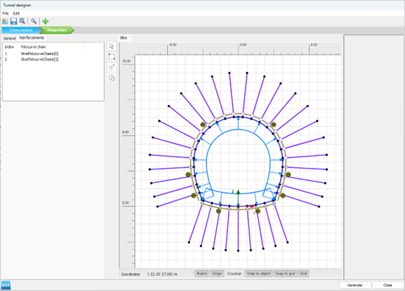

To limit the strain development within acceptable limit (between 2% and 5%), a support providing 1.6 MPa is required (see Figure 2). This can be easily achieved using a 1 m x 1 m pattern of 34 mm diameter rock bolts together with a 200 mm thick shotcrete lining.
Figure 2: Considered tunnel support system
