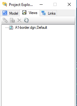

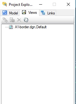

There is no icon or menu in Bentley View to open the Reference Dialog.
It would be suggested to use the Project Explorer tool to view any attached references.
This can be located under the menu > File > Project Explorer

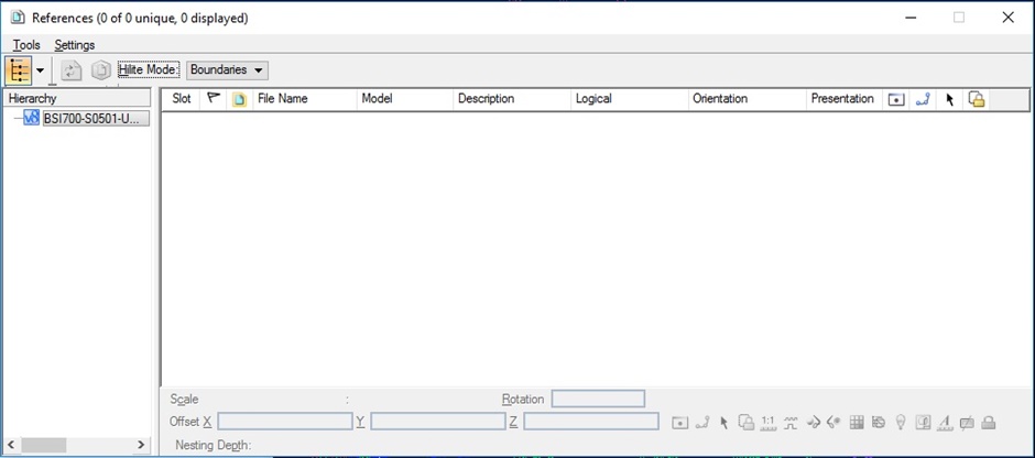

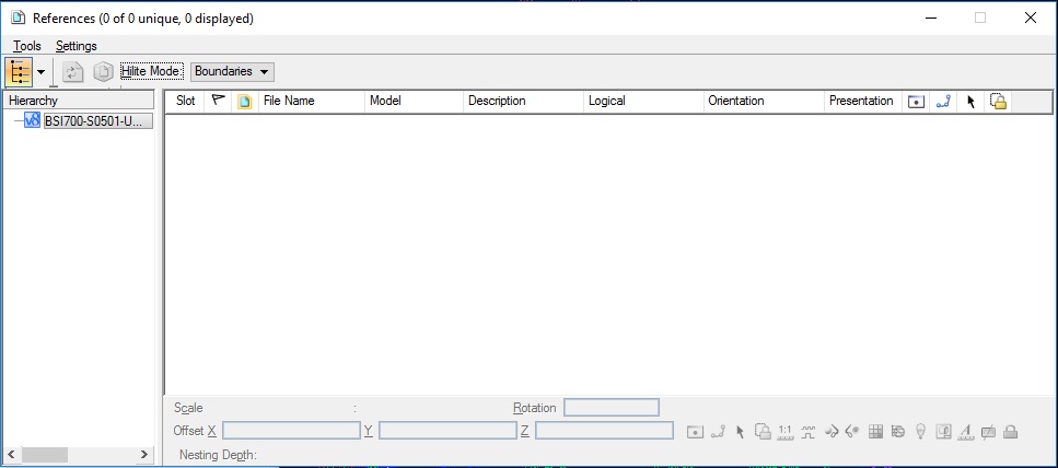

As this tool is not available from an icon, you can open the Reference Dialog using a Key-in
  1. Go to the menu Tools > Key-in
  2. Enter the Key-in: dialog reference open
  3. Reference Dialog opens
