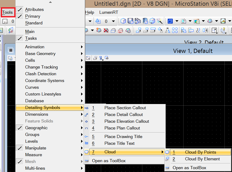

Option 1 - Toolbox:
  1. Tools > Detailing Symbols > Cloud
  2. Choose one of the available options: Cloud by Points or Cloud by Element
