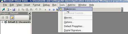

To resolve:
- start MicroStation and open a dgn file
- start Project Manager: Utlilities>Macro>Project Manager
- open the Visual Basic Editor
- in the Visual Basic Editor select menu:Tools>References

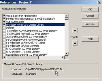

- add a checkmark in front of: MicroSoft Forms 2.0 Object Library and browse to C:\Windows\System32\FM20.dll
