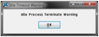

MicroStation has started displaying pop ups about the software being idle and will be shutdown.

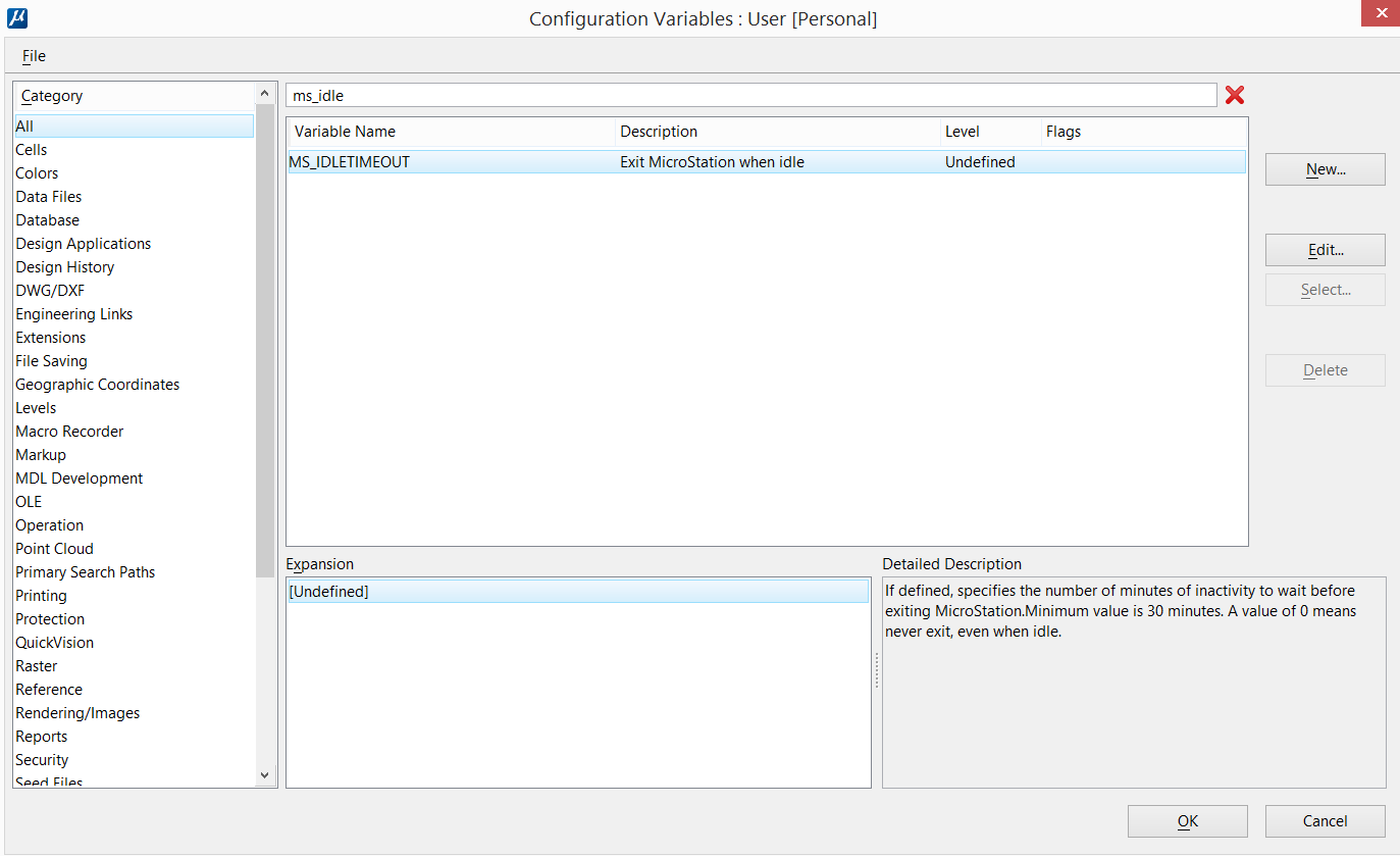

The first thing to check is if the configuration variable MS_IDLETIMEOUT  has been set, so:
 Open Workspaces menu\Configuration and check what value has this variable.

This variable is set by default as undefined.

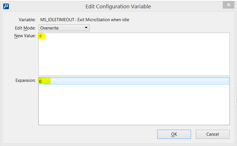

 If the value is different, you can reset value as 0 by pressing the Edit button and provide new value 0.
Once these changes are done save changes

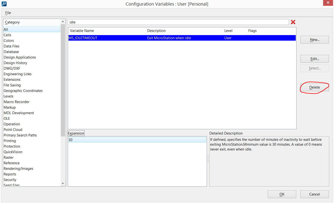

Close MicroStation down and reopen MicroStation again in order for MicroStation to read the new value for the configuration variable. Otherwise, you can delete directly the configuration variable MS_IDLETIMEOUT by clicking the delete button, press ok and save all the changes and again close MicroStation and reopen it again.
The variable will be still there but not defined by user (level undefined).
