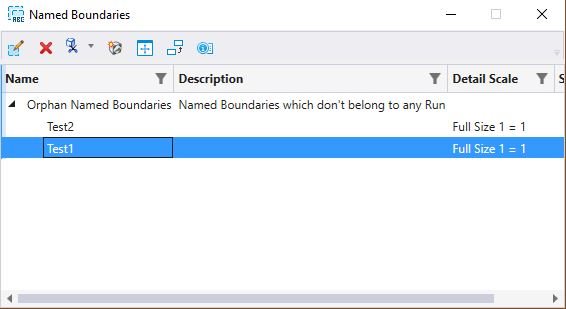

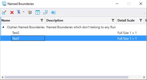

Option Two
  1. Open the Named Boundaries dialog listed under the Fence Tools
  2. Expand the Orphaned Named Boundaries folder which will list all of these Saved Fences
  3. Select the item that you wish to remove
  4. Click on the Delete button on the keyboard
