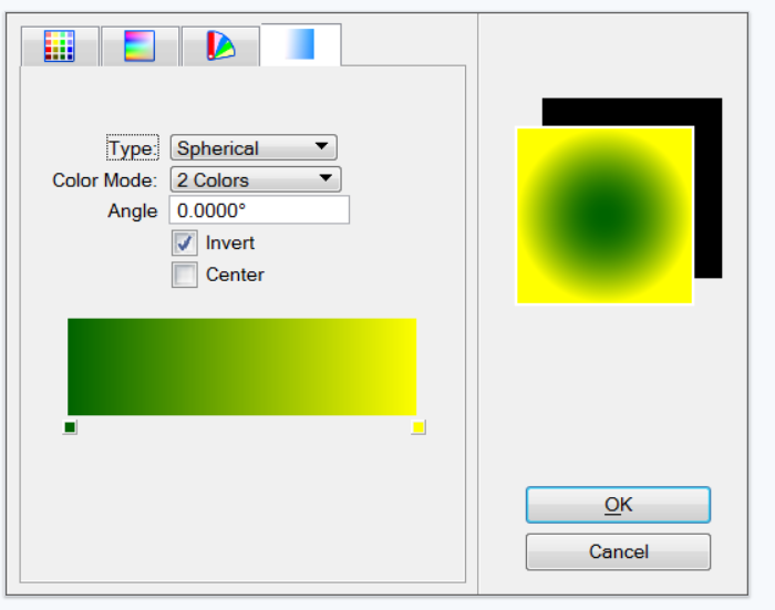

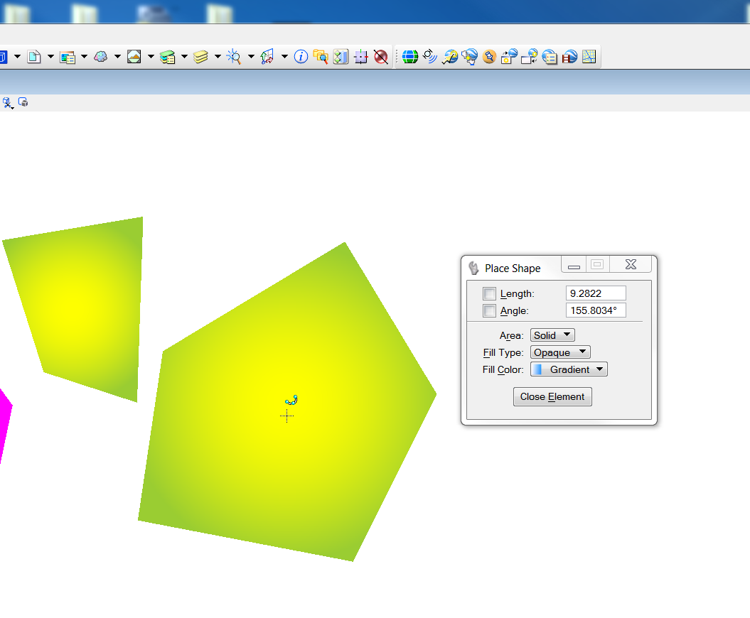

Use place circle tool
Change setting so fill type is opaque and the fill color is gradient
Click on Gradient to change more setting in order to select:
Type: Spherical
Color mode: 2 colors
And use invert or center depending on where you want to apply the darker or lighter color
Similar for shape creation
