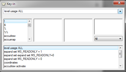

1. Open the Key-in dialog
2. Type "LEVEL USAGE ALL" - without quotation marks - and hit enter (Fig.1)

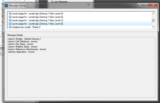

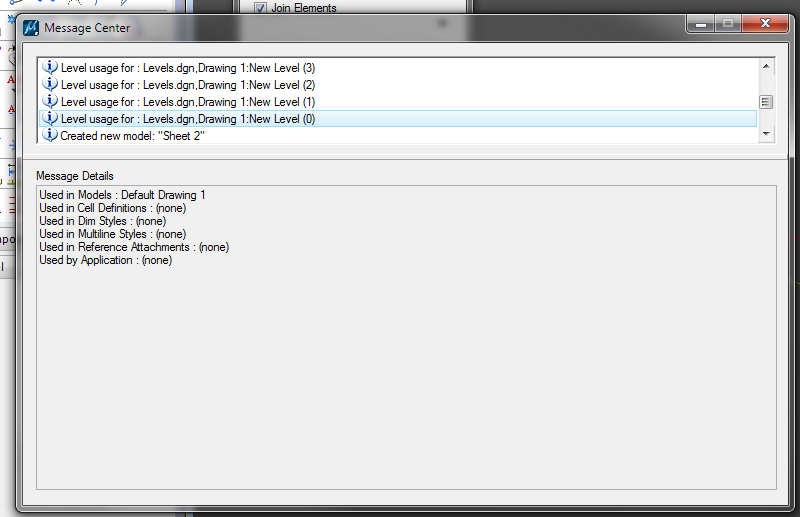

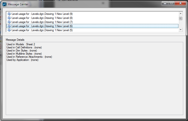

3. Open Message Centre
4. Click on each level to display the details of its usage (Fig. 2 & 3)
