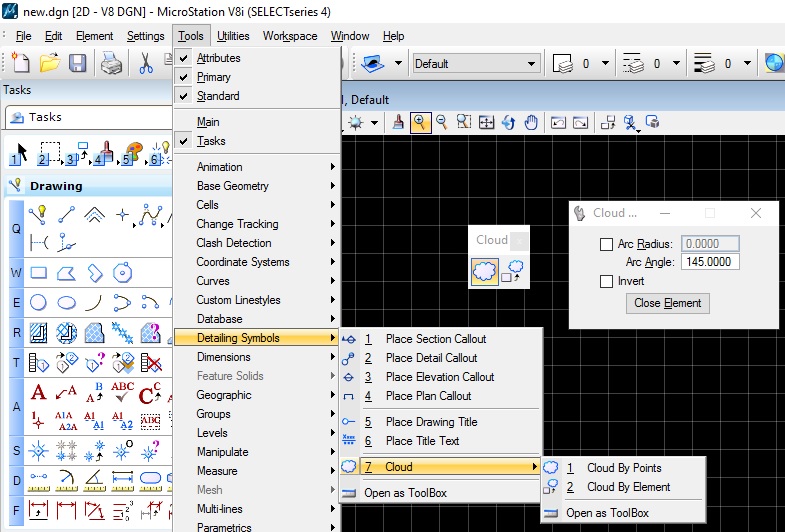

Where are the revision cloud tools in MicroStation V8i?
You can locate these tools within the following menu:
Tools > Detailing Symbols > Cloud
where you can choose to place a revision cloud either By Points or By Element
