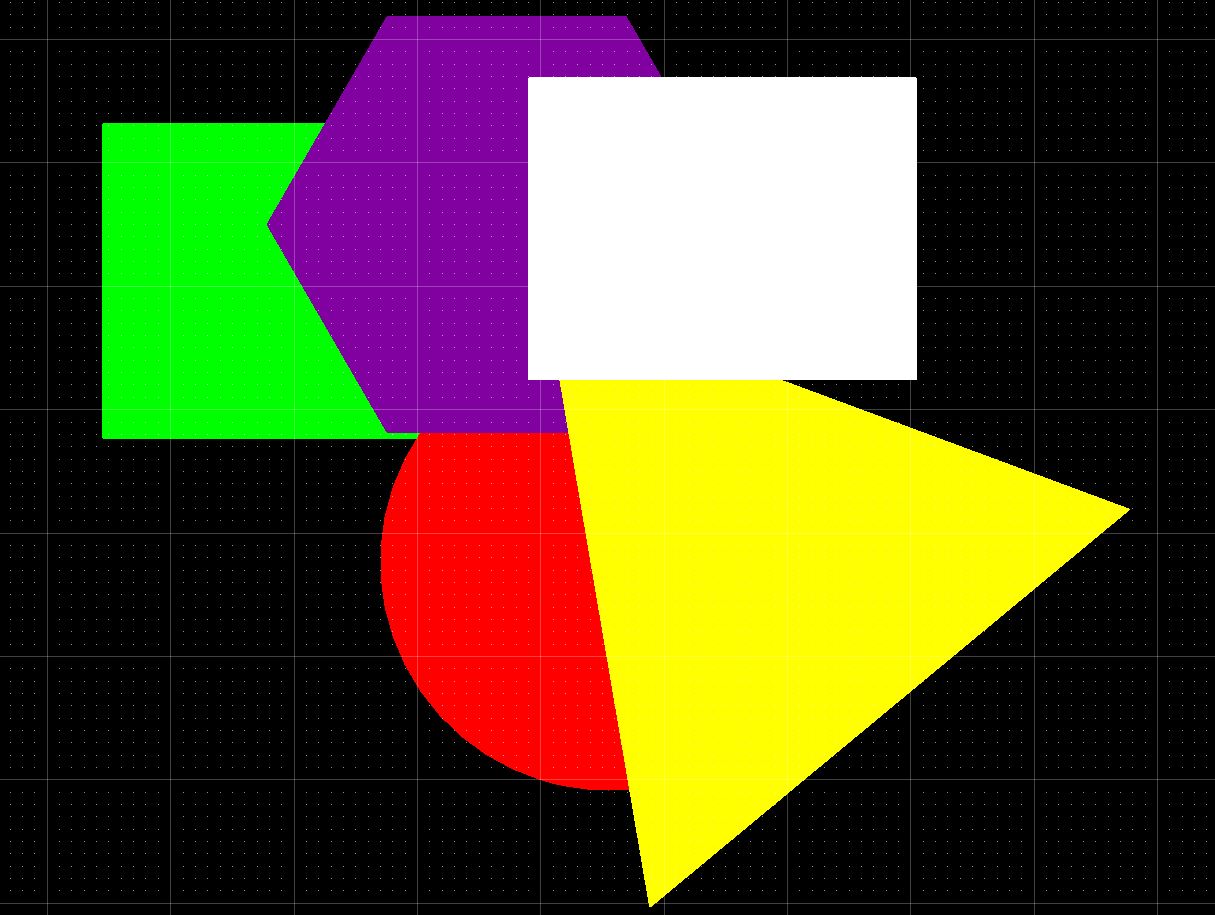

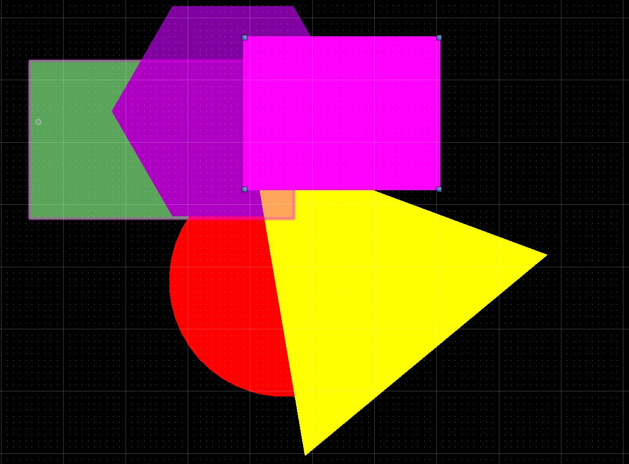

1- In the following image of different elements the White rectangule is placed in front of the others. So we are going to select it.

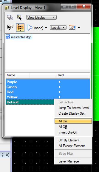

2- We are going to open Level display window and turn on all the levels.

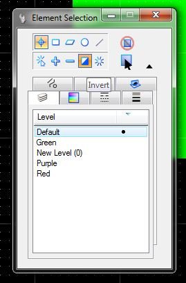

 3- Now we are going to use Element selection Invert option we will select every element in the model.

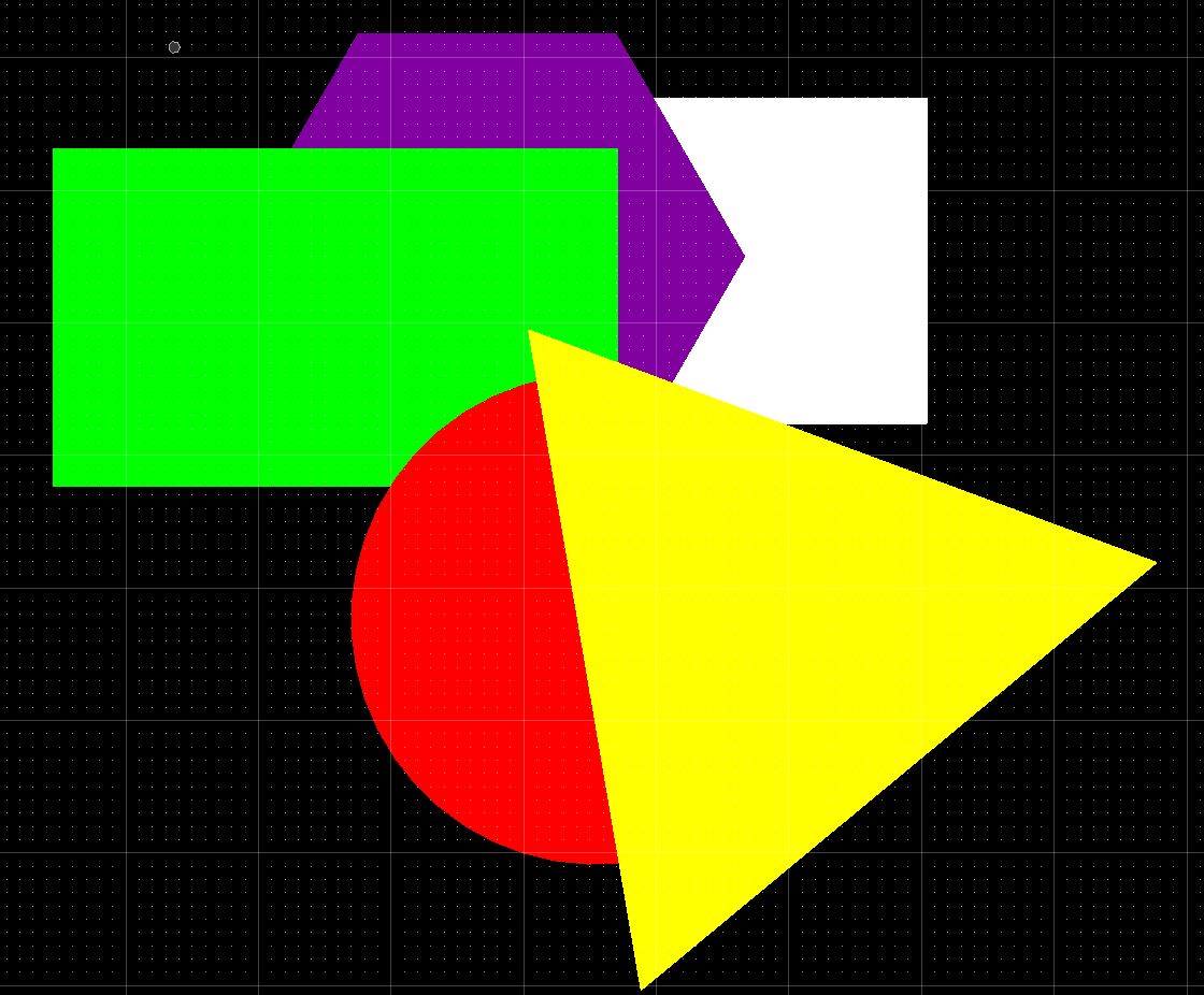

4- Going to Edit > Bring to Front command.

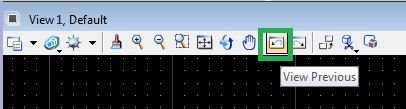

5- Now we will use View Previous command to restore the level display we had at the start of the process.
