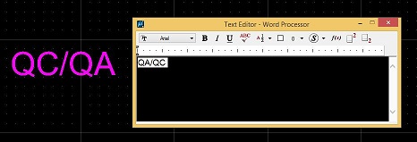

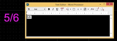

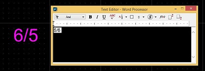

Text with Slash is displayed reverse.
This is regional specific, related to Middle East region and occurs when the System Locale is set to Arabic.

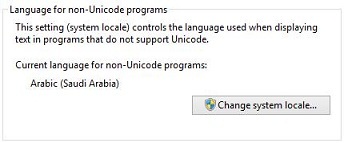

  1. Go to Control Panel > Region and Language (In Windows 8.1 its Region)
  2. Navigate to the Administrative tab
  3. Under Language for non-Unicode programs, check if the System locale is set to Arabic (Saudi Arabia).
  4. System locale settings for other Arabic countries would be
    Arabic (U.A.E.)
    Arabic (Bahrain)

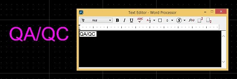

  5. Change the System locale back to English (United States) and Apply, Close
  6. You must restart windows for the changes to take effect.
  7. When you open the DGN file display is fixed.
