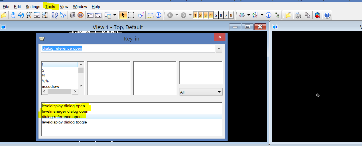

How to open level display and level manager and references dialog from Bentley View?
In MicroStation there is a series of icons available by defaults but in Bentley view you need to use key in command to launch these dialogs.
These dialogs can be opened using Key in commands.
You can open the key in dialog from Tools Menu\Key in
1. To open the references dialogs ->Tools menu \key in: dialog reference open
2. To open the Level Manager-> Tools menu \key in: levelmanager dialog open
3. To open the Level Display -> Tools menu \key in: leveldisplay dialog open
See Image below
