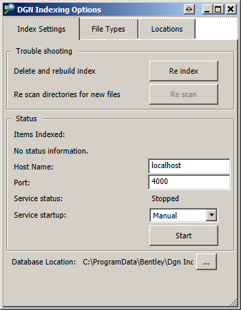

Open the DgnIndexer Options dialog:
The service startup is set to manual by default so it will not run until you change this.

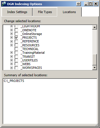

However, first go to the Locations tab and tick the boxes for any locations that you would like to index:
Sub-folders will be included, selections can be made at any point in the folder trees.

Go back to the Index Settings tab,
Change service startup from manual to Automatic.
Click Start.
The status will change to display the number of items indexed and the number currently being indexed.
