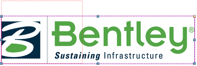

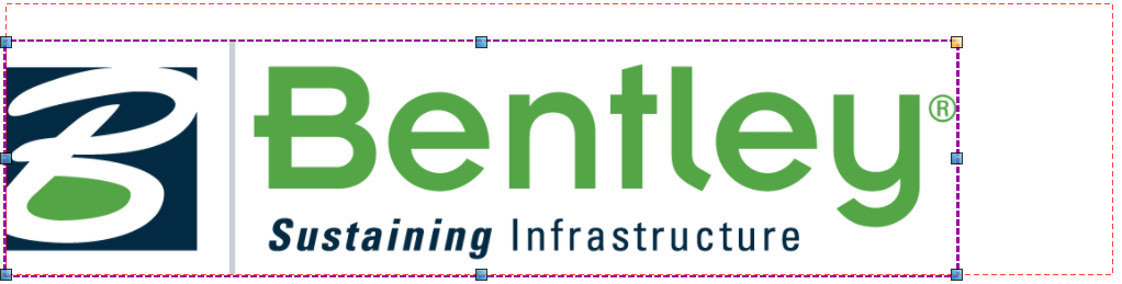

Option 1: Edit Handles
  1. Select the image
  2. Select an edit handle
  3. By default, the image will scale with a fixed aspect ratio
  4. Optional: Press [Alt] to unfix the aspect ratio
  5. Click new position of edit handle to resize
Note: This method will work if the image's aspect ratio is set to fixed in the Geometry section of the Element Information dialog. This method does not change the "Aspect Ratio Fixed" property for the image.

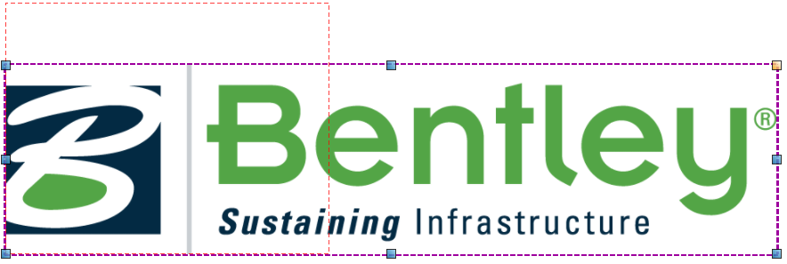

Option 2: Element Information Dialog
  1. Select the image
  2. Open the Element Information dialog
  3. Expand the Geometry section
  4. Specify if you want the "Aspect Ratio Fixed"
  5. Enter the scale factor for the axis you want to scale the image about
