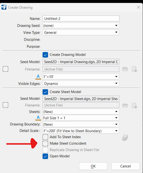

How and when to use the "Make sheet coincident." Option while creating a drawing sheet.
Make Sheet Coincident –
(Available only if the sheet model does not contain a drawing boundary)
a. To test this, used create named boundary by 2 points as shown in video.
b. With Make Sheet Coincident OFF, the reference is moved to where the sheet is placed (0,0)
c. With Make Sheet Coincident ON, the sheet is moved to where the model is (project coordinates)
