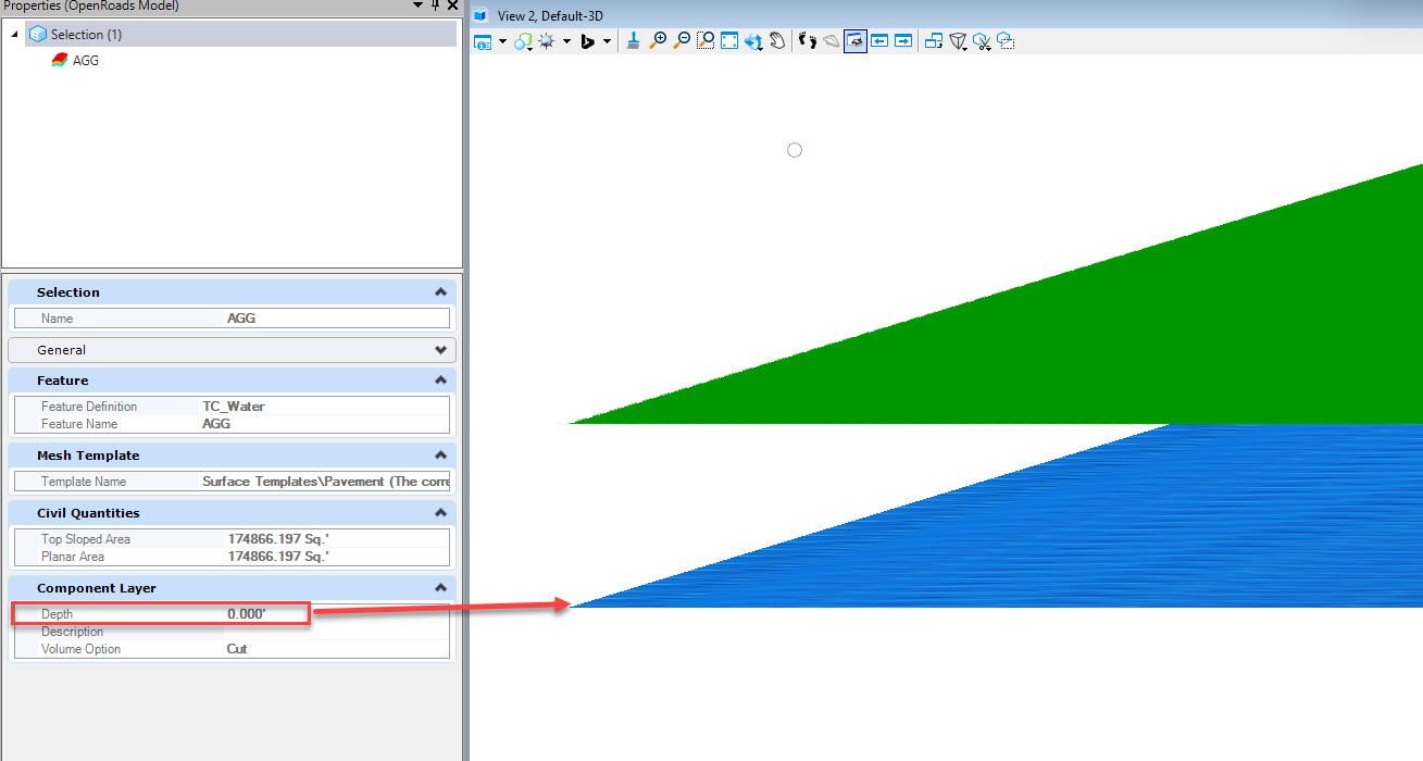

The Surface Template component is flat in the 3D model and does not have a depth ie zero depth.
A screenshot of a computer
Description automatically generated
This is a known issue that our development team is aware of. The workaround for this was to change the point constraints.

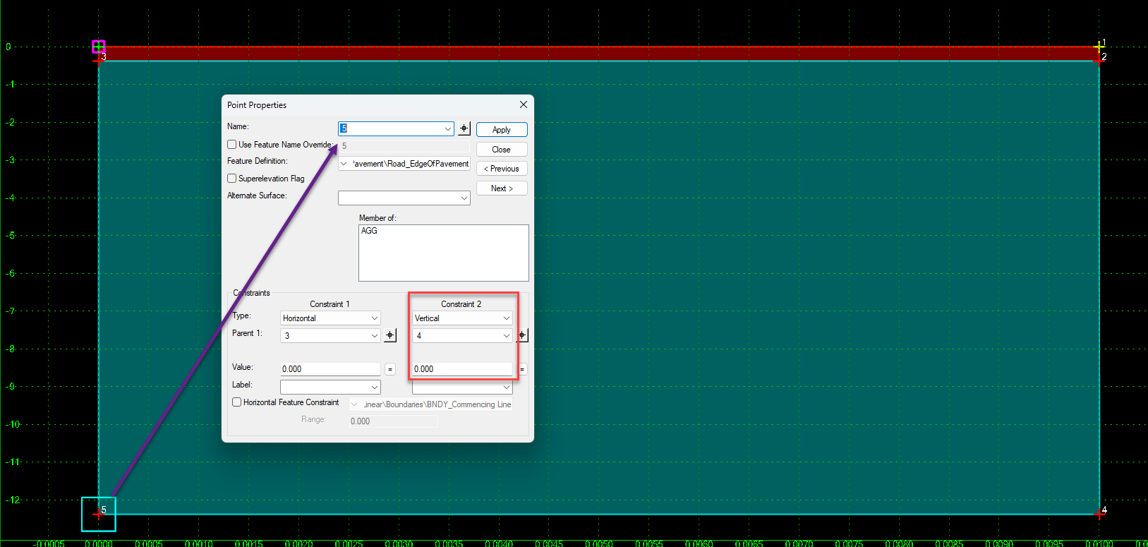

We found that changing the vertical constraint of point 5 from being vertically constrained to point 4

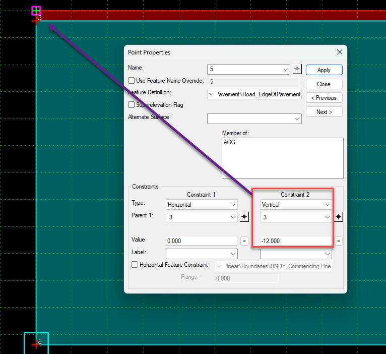

To being vertically constrained to point 3.
