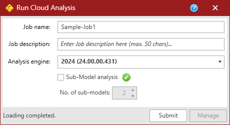

On the Analysis and Design ribbon, click on the 'Run Cloud Analysis' button.
This will first validate that required configuration setting has been applied (see above).  If the configuration is correctly defined, you will be connected to the cloud using your Bentley credentials. A valid login will then result in the following dialog being displayed:-
This provides access to both methods of cloud analysis, standard and sub-model. However if the model does not meet the prerequisites of a sub-model method, then the sub-model option will be disabled and a message to show the issue(s) that caused that action will be displayed, e.g.
Although, note that the standard cloud analysis can still be performed.
A default 'Job Name' will be provided, although this can be modified, any name should not include any spaces.
An optional 'Job description' can be provided if that can better help explain the specifics of this analysis.
The dialog displays a list of available analysis engines in a drop list. Each item in the list relate to the engines that ware associated with specific published versions of STAAD.Pro. This allows you to perform an analysis using a different version of the program without having to install that version locally.
The default engine will be the most current from a list of compatible engines that are available using this service. Note that the service may offer a different set with more current published versions of STAAD.Pro. By choosing an older version of the analysis engine, it is possible to obtain the results that would have been produced using that version, but without having to do a local installation.
If the prerequisites of a sub-model analysis have been met, the option to perform a sub-model analysis can be checked. With this option, on clicking 'Submit' two or more duplicates of the model (as defined by the control 'No. of sub-models) will be created which will contain one or more load cases such that all the sub models contains all the primary load cases. Note that a sub-model that includes any load case that itself includes a reference to another load case will include both load cases.
The Submit button will then initiate the process of performing the cloud analysis using the chosen configuration.

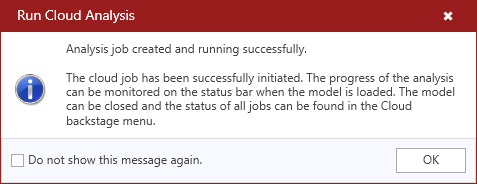

If a standard analysis method has been specified, then the cloud service will be initialised, the model uploaded and analysis started. If there are any problems during this phase then an information message will be displayed.
If successfully initiated, the following will be displayed:-
Whilst the analysis is running the status of the analysis is displayed on the Status bar, e.g.
It is now possible to close the model in STAAD.Pro and work on other projects or close STAAD.Pro down entirely.

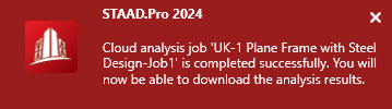

When the cloud analysis has completed, if the model is open, a pop up message is displayed such as:-
and with the model loaded in STAAD.Pro, the status bar reports this:-

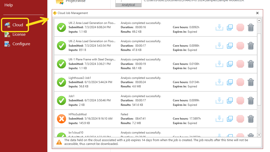

Note that results produced from a cloud analysis have a limited lifespan on the server. They will be held on the server for a period of 14 days during which they can and should be downloaded. After this period, they will be removed from the server.

Check Status of Cloud Analysis Jobs
The status of all jobs that have been uploaded for a cloud analysis can be checked by clicking on the 'Cloud' option in the Backstage:-
