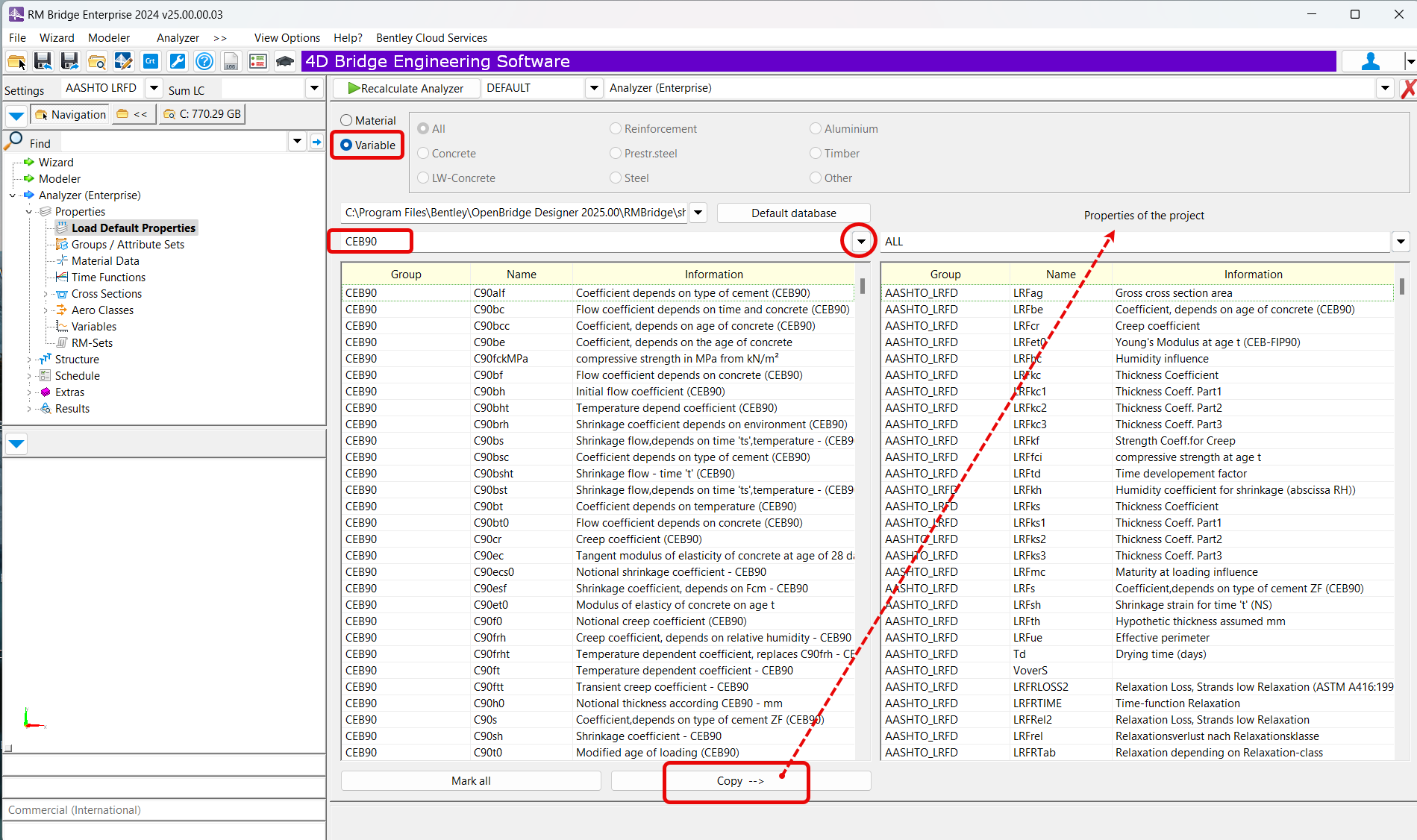

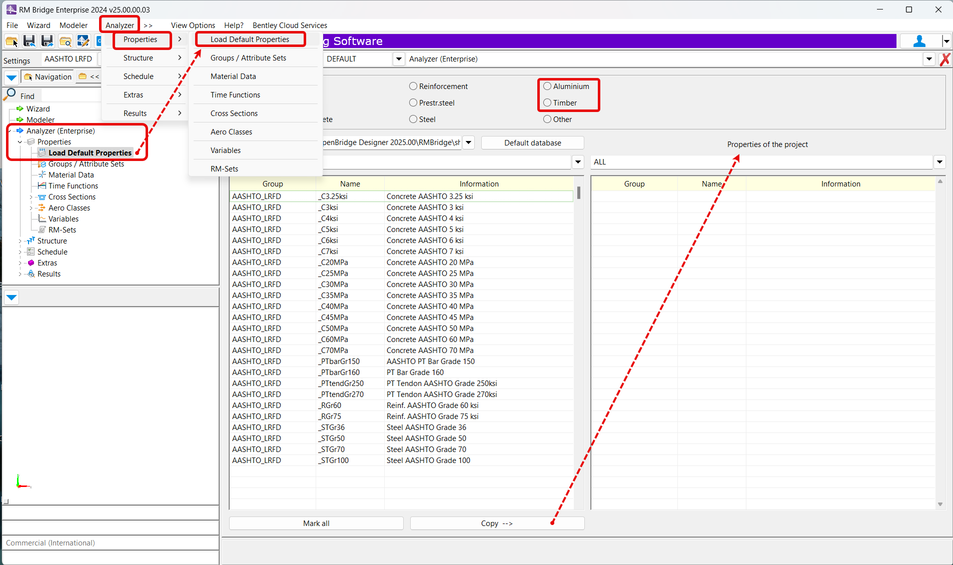

The Load default properties allow users to copy materials or variables from the standard database into the project database. Variables are creep, shrinkage, and relaxation models. Default definitions are read from the default database and may be chosen in accordance with the national design code.
As shown below, the default properties from the left table can be loaded by copying them to the right table with the project properties.
Note: In the Recalc menu, imported variables may be bypassed. In RM Bridge directly coded creep and shrinkage models could then be used. In this case, user-defined changes in the variable definitions are ignored.
