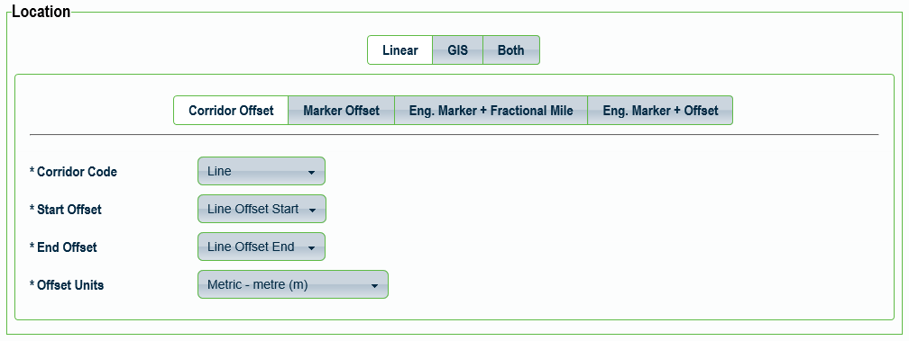

Corridor Offset
Corridor offset is the simplest method of measurement. It is used when the linear position of the data is measured as a simple offset from the location at which the corridor starts in Linear Analytics Services. It is rare for data coming in from third party software or hardware to be able to use this option, but if data has been pre-processed or previously exported from existing data that is in Linear Analytics Services then it may be used. Using corridor offset is straightforward, in that you just have to specify which column in the file contains the name of the corridor, which column (or columns) in the file contain the actual corridor offset, and what the units are in which that offset is measured.

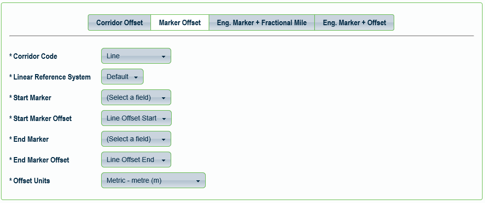

Marker Offset
Most rail systems measure location using a series of fixed markers. Kilometre posts or mile posts are the most common of these markers, but others are also sometimes used. Assets, events, and other things that need to be located on the railway using a linear location are located using a combination of the named marker and an offset from that marker.
When importing data into Linear Analytics Services from a file, selecting the "Marker Offset" method of measurement will allow you to import data that uses a marker and a linear offset from that marker, with the marker and the offset contained in separate columns. You must select which column in the file contains the corridor name, the marker name, the offset, and the units in which the offset is measured.
