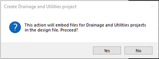

          1. Open the utility basemap where the extraction will happen.
          2. If a Drainage and Utilities Project has not been created in this file yet, then you will have to do this by selecting  Drainage and Utilities tools like Extract from Graphic)

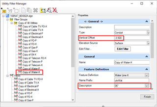

          3. Next open the Filter manager. (if a Drainage and Utilities project has not been created in this file yet, you will have to do this)
          4. Now copy the All utilities Filter group from the OHDOT_Features_DrainageAndUtilities.dgnlib and paste into the active file section.
             Now you have a copy of the utility filters that can be edited.
          5.Now you can select a filter and change the vertical offset or the size (Description)
