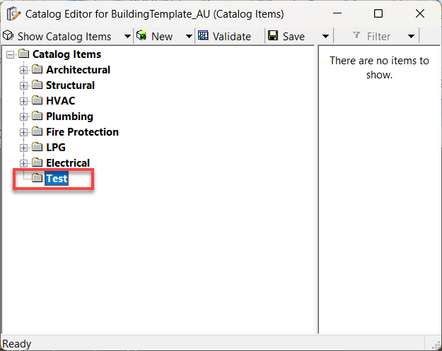

I have created a new Discipline Group on the Catalog Editor. But I am not able to find the corresponding changes except on the user interface. Where do I find that?

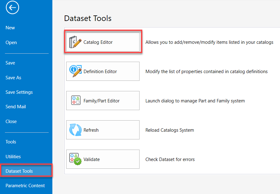

  1. Once a new Discipline Group has been created on the Catalog Editor, it can be explored easily from the Catalog Editor itself on OBD user interface. To open the Catalog Editor,
    Go to File > Dataset Tools > Catalog Editor
  1. Then the new Discipline Group can be accessed from there alongside all the other existing Discipline Groups.
