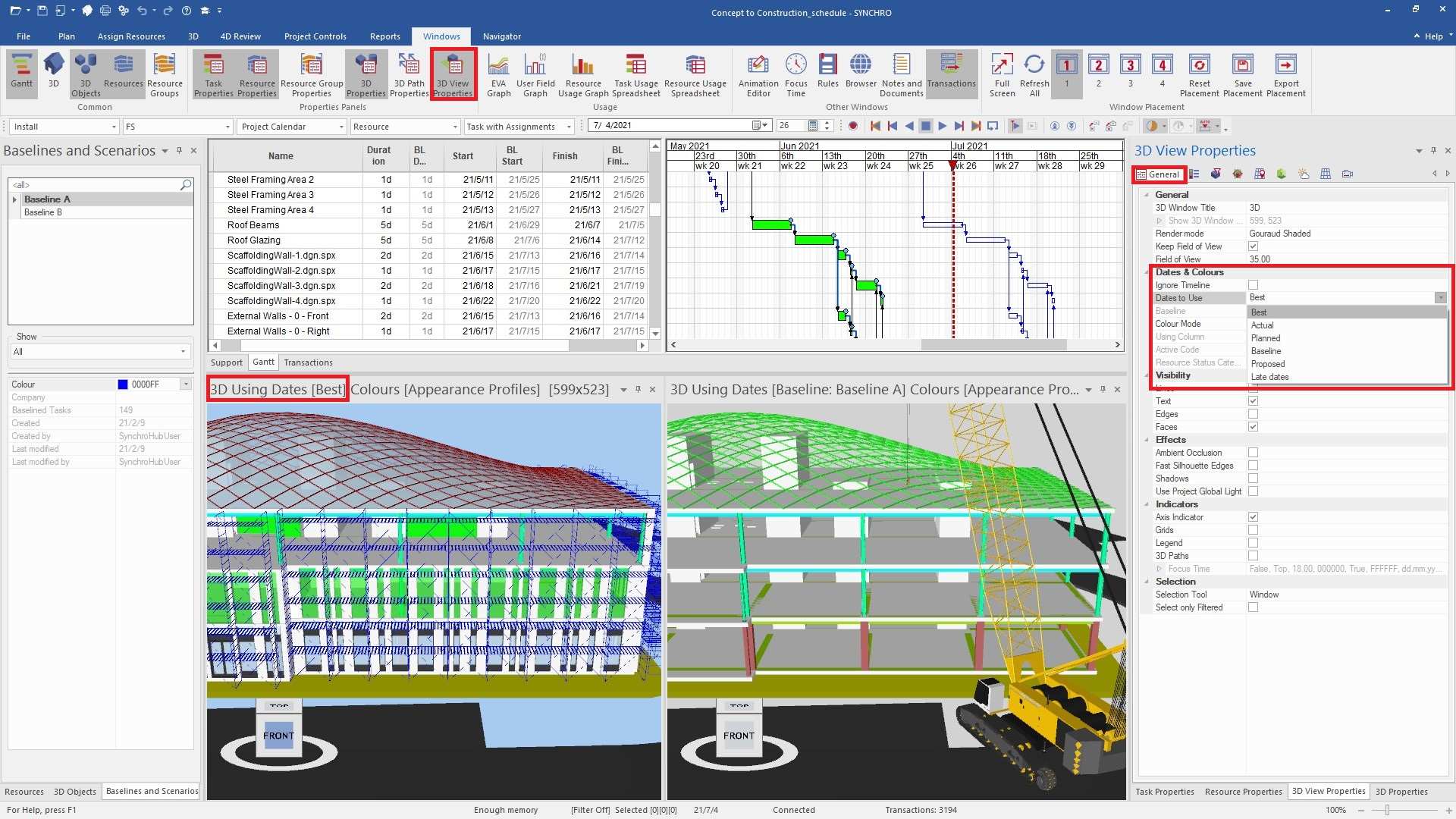

When we visualize our SYNCHRO 4D model in 3D Window we can choose the following dates to use in the active 3D window:
· Best
· Actual
· Planned
· Baseline
· Proposed
· Late dates
                                                                          Dates to Use
Dates to Use

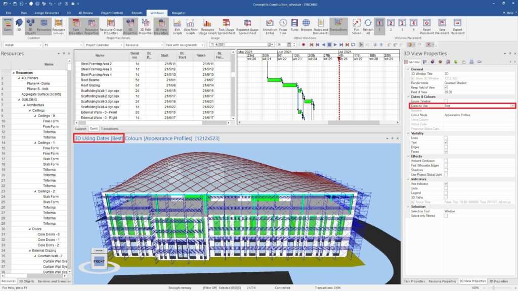

1. Best
To begin with, the SYNCHRO 3D window shows 4D simulation of our current schedule, a combination of actual + planned dates (past + future).
If the project hasn’t started, Best = Planned (all tasks are in the future from data date).
This is the default dates to use setting.
                                                                              Best

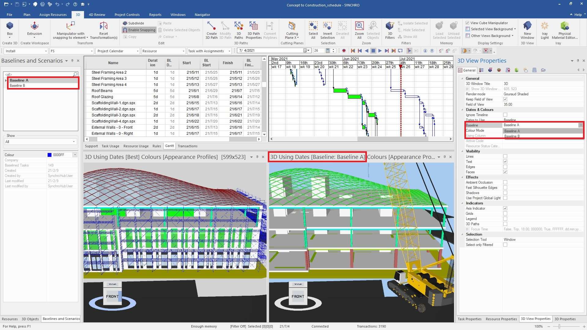

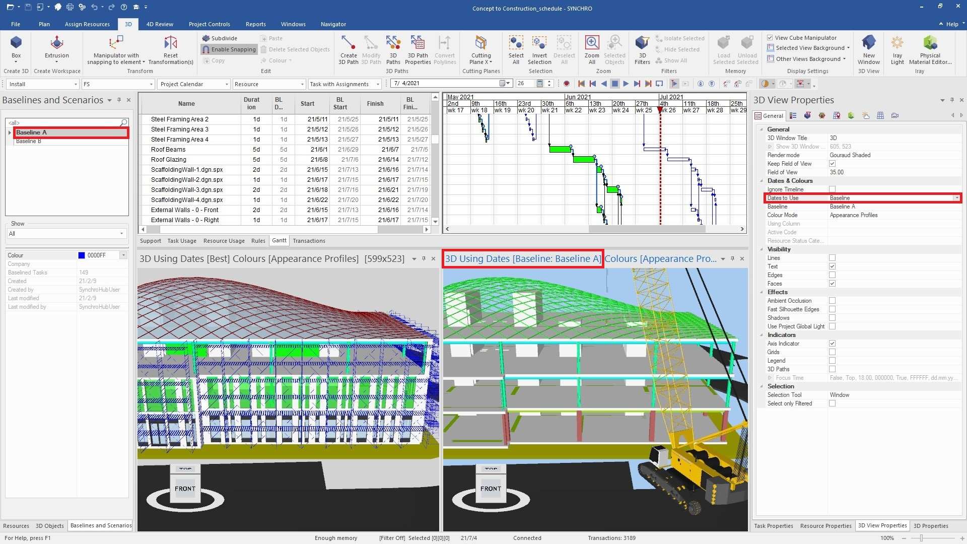

4. Baseline
In this case, 3D window will show 4D simulation of saved baseline, which might be our Baseplan or Scenario. This option is applicable only if we have created at least one baseline.
                                                                            Single Baseline
In case we have created more baselines, we choose, which one we want to show
                                                                        Multiple Baseline
This option is used to compare actual progress to the initial schedule (baseplan) or alternative construction scenarios
