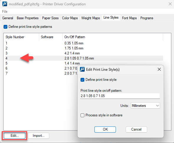

When generating printed output from MicroStation, the DGN default Line Styles (1-7) dash and gap’s are generated from a pattern of On (pen down) and Off (pen up) movements, defined in the selected Plot Configuration File (*pltcfg).
For Example,
MicroStation Line Style 4
A black line on a white backgroundDescription automatically generated
Is made up from 2.8 on 1.05 off 0.7 on 1.05 off pattern, before being repeated depending on the length of line. The default units being mm for each on/off portion of the pattern by default.
To adjust these on/off values that make up a Line Styles printed pattern, the Plot Driver Configuration File being used needs to be modified. To do this:
  1. Identify the *.pltcfg file being used, (This is displayed at the top of the Print dialog)
  2. Select File > Edit Print Driver Configuration to open the file for edit.
  3. Optional:         If at the top of the dialog it states (Read Only) or you do not want to modify the existing *.pltcfg it will need to be saved under a new name
Select File > Save As, a dialog will appear offering you to change the label (Up to you)
Enter a new File Name as required (Modified.pltcfg)
  1. Select the ‘Line Styles’ tab
  2. Select the Style Number (MicroStation Line Style 1-7) to be edited, followed by clicking the ‘Edit’ button
  1. Adjust the values in the ‘Print line style on/off pattern’ field as required (Note the Units: can be adjusted if required) then select OK
  2. Repeat step 8 for the other Line Style numbers as required
  3. Select File > Save and close the dialog
  4. From the ‘Print’ dialog either select File > Reload Print Driver Configuration if existing *.pltcfg was edited or File > Select Print Driver Configuration and choose the new *.pltcfg
  5. Produce a test Print to confirm.
Printer Driver Configuration Dialog, Line Styles Tab
