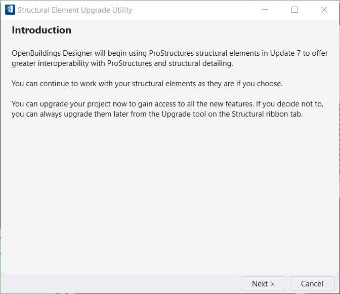

· On opening a file containing legacy structural elements, the software detects their presence, and the following window appears. You can choose to upgrade at the time of opening the file and click on ‘Next’. Alternatively, you can select Cancel and open the file as it is
Structural Element Upgrade Utility

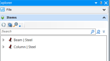

· If you have opened the file without upgrading the legacy structural elements, these elements would be visible in the Items section of the Explorer as Beams and Columns. This changes after the upgradation, we will see this later.
Items – Explorer

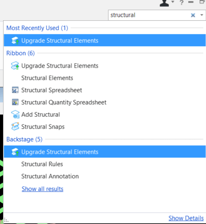

· There are two ways of accessing the Structural Element Upgradation Utility once the file is opened. The easiest way to access the Utility tool is by typing in the Ribbon:
Ribbon Search

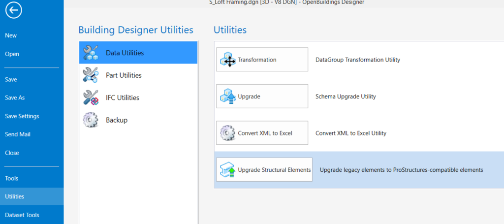

Alternatively, one can go to backstage by clicking on the File tab, followed by Utilities > Data Utilities > Upgrade Structural Elements.
Backstage Utilities
The Structural Element Upgrade Utility window (same as mentioned in point 1) appears.

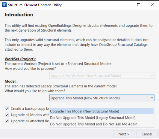

On clicking Next, the following screen appears
Upgrade Model
Here, the Work set is already set to Enhanced Structural Mode, so the option of Upgrading the Work set is disabled. Otherwise, one must select the option from the dropdown.
Since the Model has Legacy Elements, choose ‘Upgrade This Model’ option from the dropdown below the ‘Model’ section. The other options in the dropdown would enable a user to work in the legacy mode. This selection enables the options/toggles for backing up the file, upgrading all models, and upgrading attached references. Then click on ‘Next’ and the following screen appears.

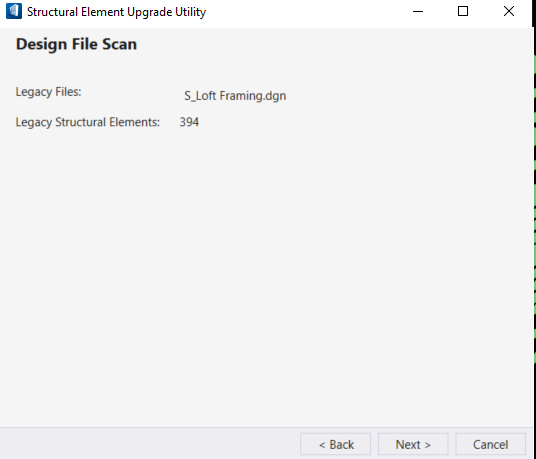

Design File Scan

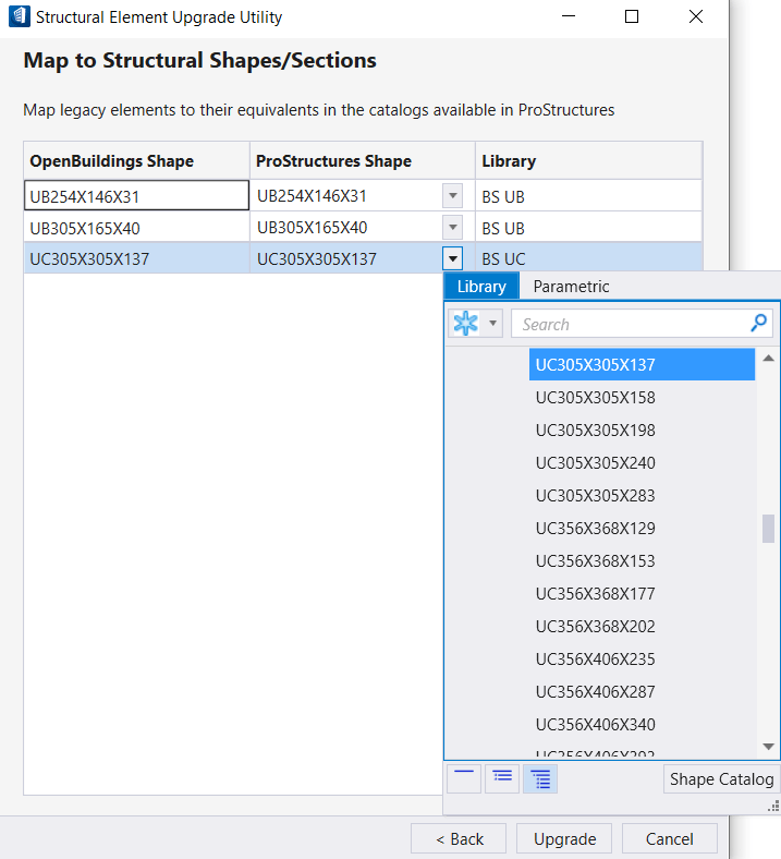

After one more ‘Next’, the mapping window appears.
Map to Structural Sections
Here, the legacy Structural Elements are mapped with the corresponding sections from the Pro-Structures library, or with the corresponding parametric sections for Concrete Rectangular or Circular Sections.
Once done, click on Upgrade.

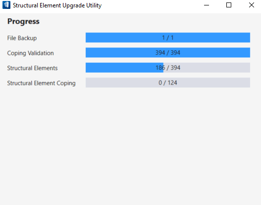

Progress Check
The next window will display the progress of the process and will notify when over.

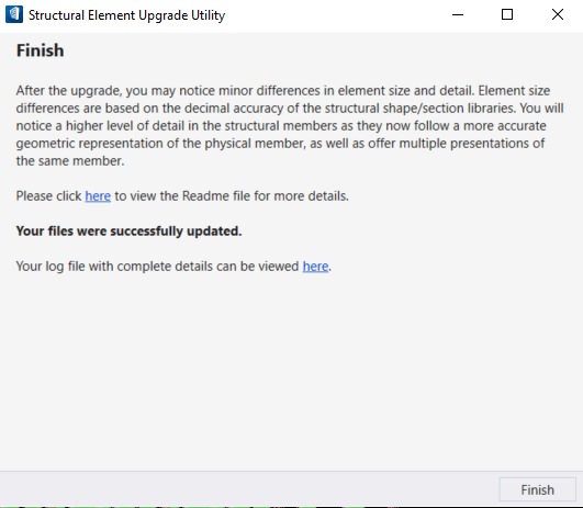

Click on ‘Finish’ and the Legacy Structural Elements are now Pro-Structures Elements.

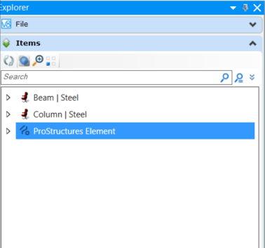

Note that now in the Explorer section, in the ‘Items’ section, apart from Beams and Columns, there is another item, ProStructures Elements. So now, the structural elements are being recognized not only based on their functions (beams and columns) but also as ProStructures Elements.
