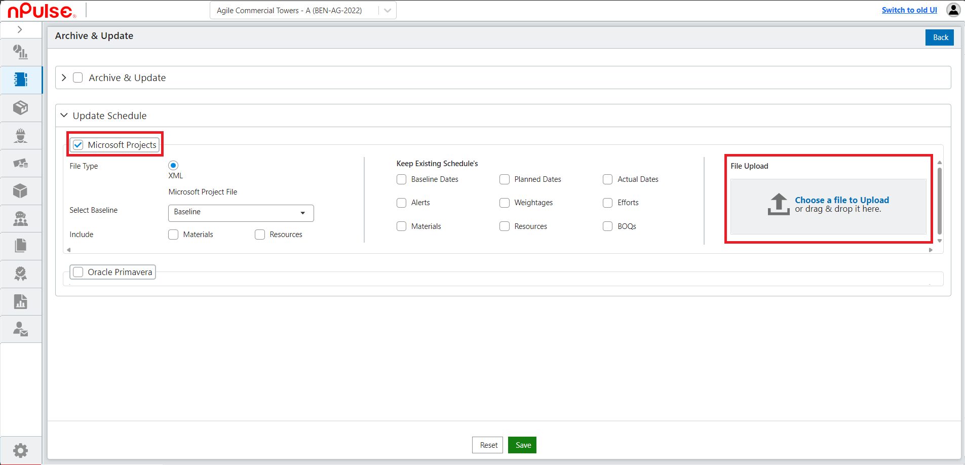

Importing Microsoft Project Schedule
- Select the Microsoft Project checkbox under Update Schedule.
- The file type will be automatically set to XML, as nPulse only supports importing schedules in this format.
- Choose the Baseline in the Select Baseline drop-down. nPulse supports up to Baseline10 during selection, but only one baseline can be maintained and displayed at a time.
- Ensure all checkboxes under keep existing's schedule are unselected for the first schedule upload.
- Click "Choose a file to upload" and select the schedule file (in XML format).
- Click "Save" to upload the schedule. The upload time may vary depending on the schedule size.

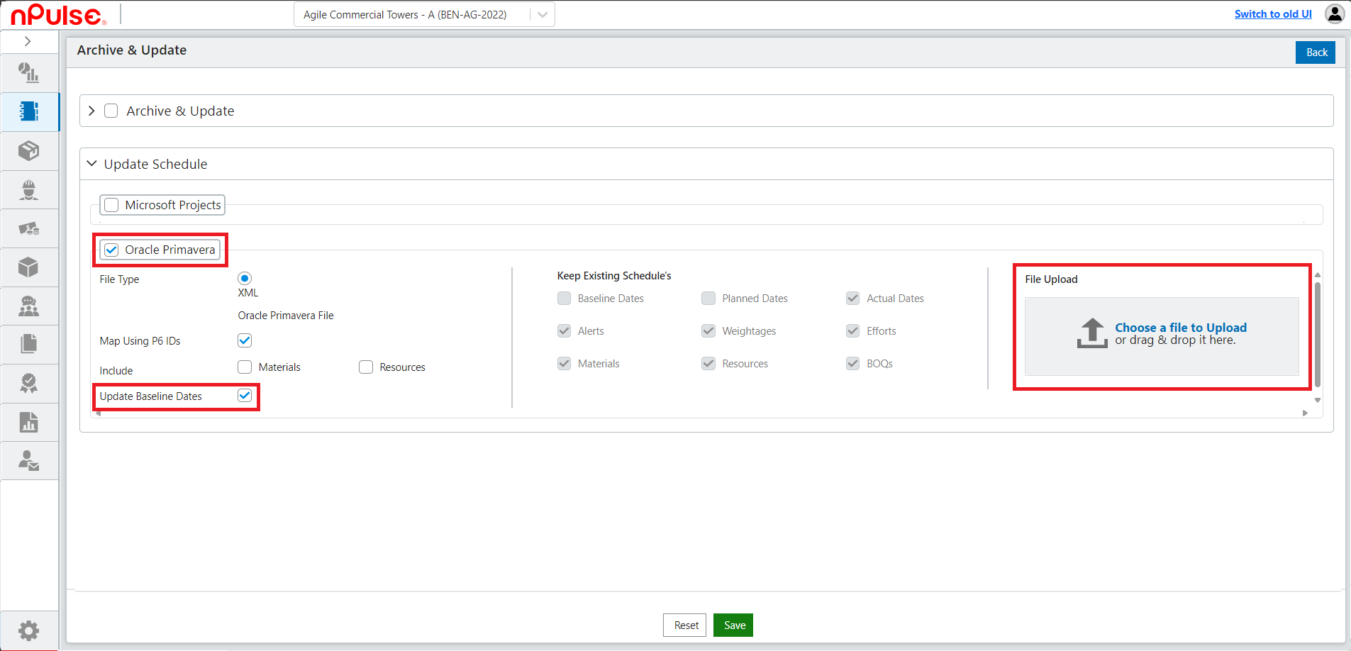

Importing Primavera P6 Schedule
- Select the Oracle Primavera checkbox under Update Schedule.
- Enable the "Map using P6 IDs" checkbox. The P6 IDs will be used as task codes in nPulse.
- Select the "Update Baseline Dates" checkbox to ensure that the baseline dates maintained in P6 are considered as baseline dates in nPulse. The start and finish dates from P6 schedule will be taken as planned dates.
