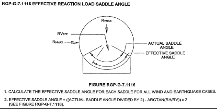

Angle reduction is used to account for transverse loads with Zick's method.
This effective angle comes from the TEMA 8th RGP rules and/or Dennis Moss' book.

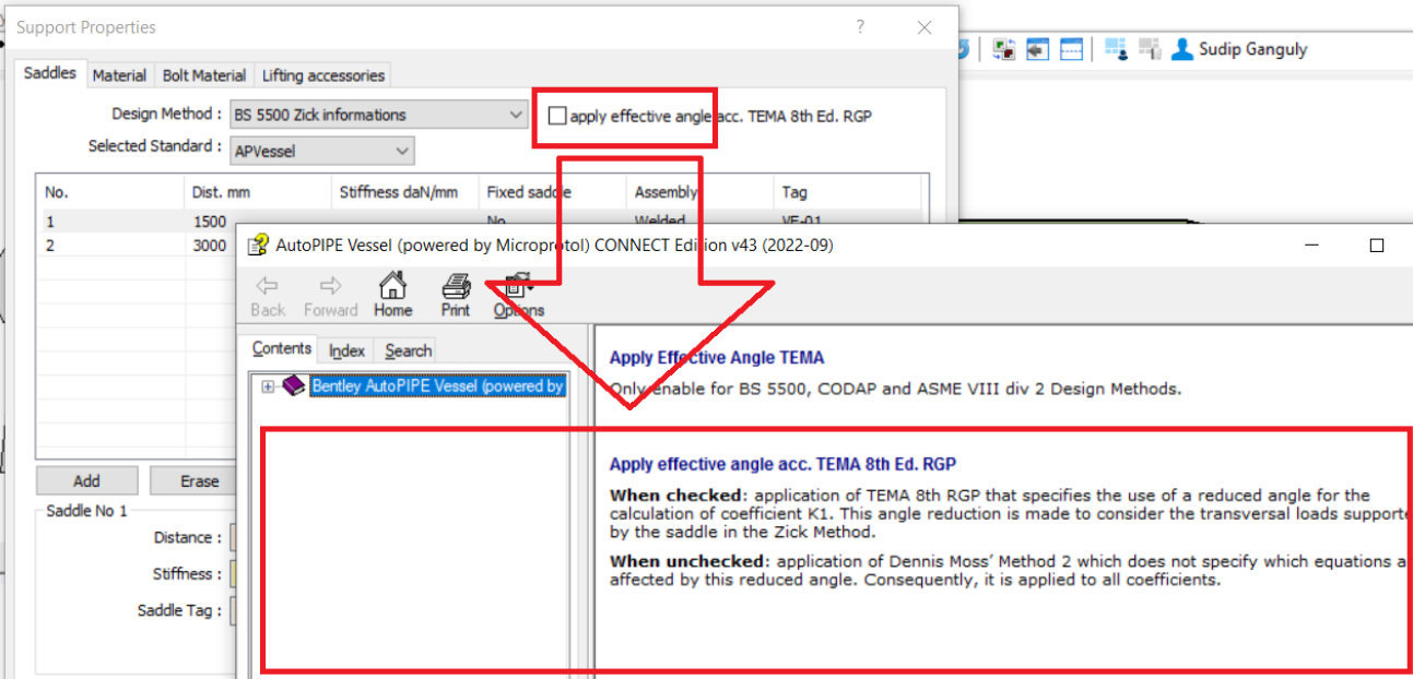

This effective angle calculation cannot be disabled.
As Sudip said the blast condition is the worst for this angle, a small effective angle can mean that the transverse horizontal loads are very large and not balanced by the weight of the vessel. In this case, another mode of support should be considered to deal with the blast condition in order to preserve the integrity of the vessel body at the supports (i.e. a square saddle).
Also, mentioned in reference help '?'

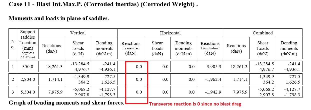

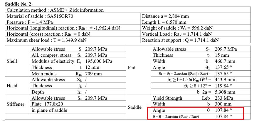

Let's consider what happens to the saddle 2 design. In this case the horizontal transverse reaction is 0:
Hence the effective angle is same as actual saddle angle (107.84 deg >30 deg) and the saddle design passes:

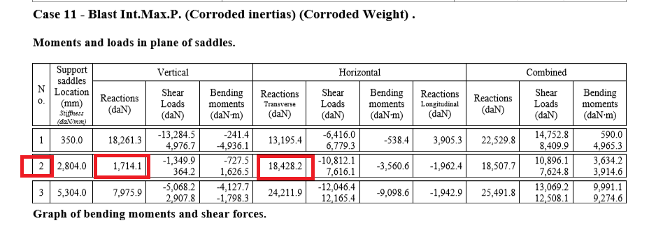

When you applied very high wind dynamic pressure for a load case (i.e blast analysis), it lead to high horizontal transverse reaction (ex. 18,428.2 daN)
Hence now the effective angle theta
theta= 107.84 - 2.arctan(Rah/Rav)
theta= 107.84-2.arctan(18,428.2/1,714.1)
theta= 107.84-2.arctan(10.7509) < 0
Note: less than 0 makes no sense, so theta = 0.
Therefore, the error and the saddle design needs modification.

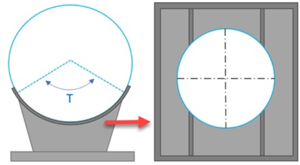

You can prevent this error by implementing one or more of the following options: :
      1. Increase Saddle Contact Angle (T)
      2. Increase Base Plate Length (B)
      3. Increase number of Saddle
      4. Change the saddle locations
      5. Reduce the external loads
