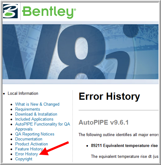

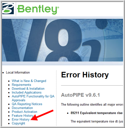

Option #2: Installed document (partial error history):
AutoPIPE V8i 09.06.01.xx and higher:
"Installation folder" \autopipe_readme.chm... after being opened see the "Error History" hyperlink under the "Local Information"
AutoPIPE V8i 09.06.00.xx and Lower:
"Installation folder" \readme_autopipe.htm
After the file is open, see the "QA Reporting Notices" section for details. However, note that the www.Bentley.com web site mentioned in this document has been updated per the new QA&R process mentioned above.
