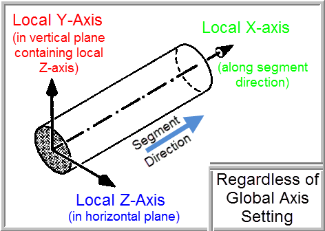

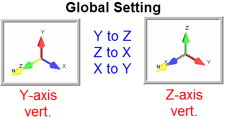

Can you confirm that my understanding of global/local axes is correct with respect to the listings of coordinates in output files.
For a model with Z specified as the global vertical axis, when I print an .OUT file with forces set to local, the COORDINATES DATA LISTING (which I understand are global coordinates) shows Y as vertical.  This can be checked by looking at the output report
If, however, you generate an output  file with forces set to global, Z-axis is vertical .
I'd like to confirm that if forces are set to local, global vertical is Y in the  COORDINATES DATA LISTING part of the output file.
Answer:
Regardless of the Global vertical axis (Y or Z),
The local axis is always the same as mentioned in the online help:
Local axis directions when +Z-axis is vertically up
Model Options
