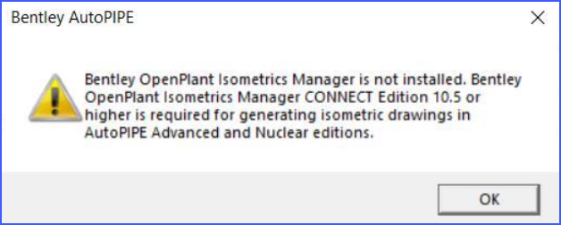

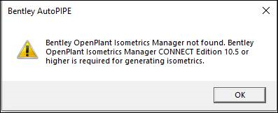

The following appears in AutoPIPE when trying to create Stress Isometric:
Bentley OpenPLANT Isometrics Manager not found, Bentley OpenPlant Isometrics Manager CONNECT Edition 10.5 or higher is required for generating isometrics.
OK
Bentley OpenPLANT Isometrics Manager is not installed. Bentley OpenPlant Isometrics Manager CONNECT Edition 10.5 or higher is required for generating isometrics in AutoPIPE Advanced and Nuclear editions.
OK

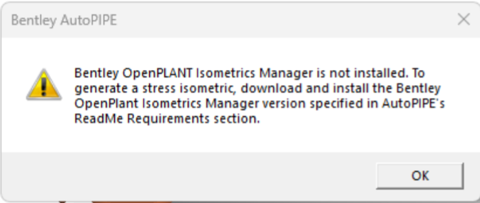

Bentley OpenPLANT Isometrics Manager is not installed. To
generate a stress isometric, download and install Bentley
OpenPlant isometric Manager version specified in AutoPIPE's
Readme Requirements section.
OK
Why and How to resolve?
  1. Do you plan to generate a Stress Isometric?
  2. Do you have user entitlements to license AutoPIPE Advanced or AutoPIPE Nuclear?
If Yes to both questions,
Yes, we/I plan to generate a Stress Isometric drawing from an AutoPIPE Model. Therefore, as the message above indicated, OPIM has not been installed. Remember that OPIM is a different application than AutoPIPE with a completely different installer. Therefore, at anytime, download OPIM separately from AutoPIPE and manually install OPIM from the newly downloaded OPIM file.
Install OPIM.
Under "How do I download, install, and license AutoPIPE?"> select a hyperlink from list of available versions> click on hyperlink for "Step #1: Download. This page provide details to download and install some dependencies required by AutoPIPE, one of which is OPIM (OpenPlant Isometric Manager).
