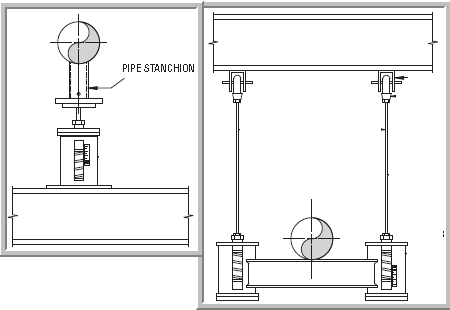

Can AutoPIPE model friction at a spring support?
Yes and No

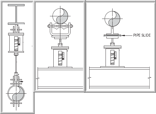

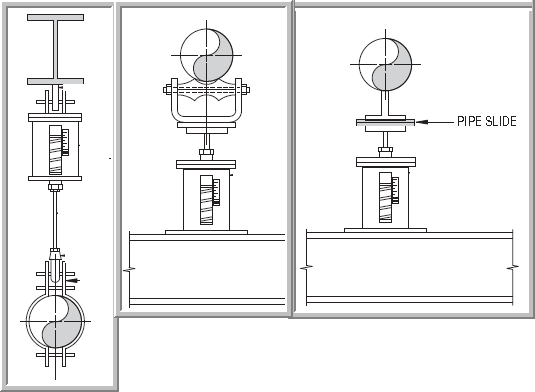

Most supports types in AutoPIPE have a field for the user to enter in a Friction Factor value. However, for Support Type = Constant or Spring, there is no such field. Typically when spring support is used in supporting piping a roller support, pin connection, low friction pad, or other are used to prevent transferring a lateral load to the spring support.

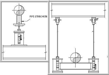

A lateral load could prevent the spring can from operating correctly and as a result cause irreparable damage to the piping system. There are support details that do not use these aids, the most typical detailed being the pipe resting on a flat plate or beam supported by spring hanger(s), as pictured below:
This very type of support example is provide in the AutoPIPE help. Please see the following Help location for details:
Help > Contents> Contents Tab> Modeling Approaches> Modeling Approaches> Supports> Model 7: Spring Can with Friction:
