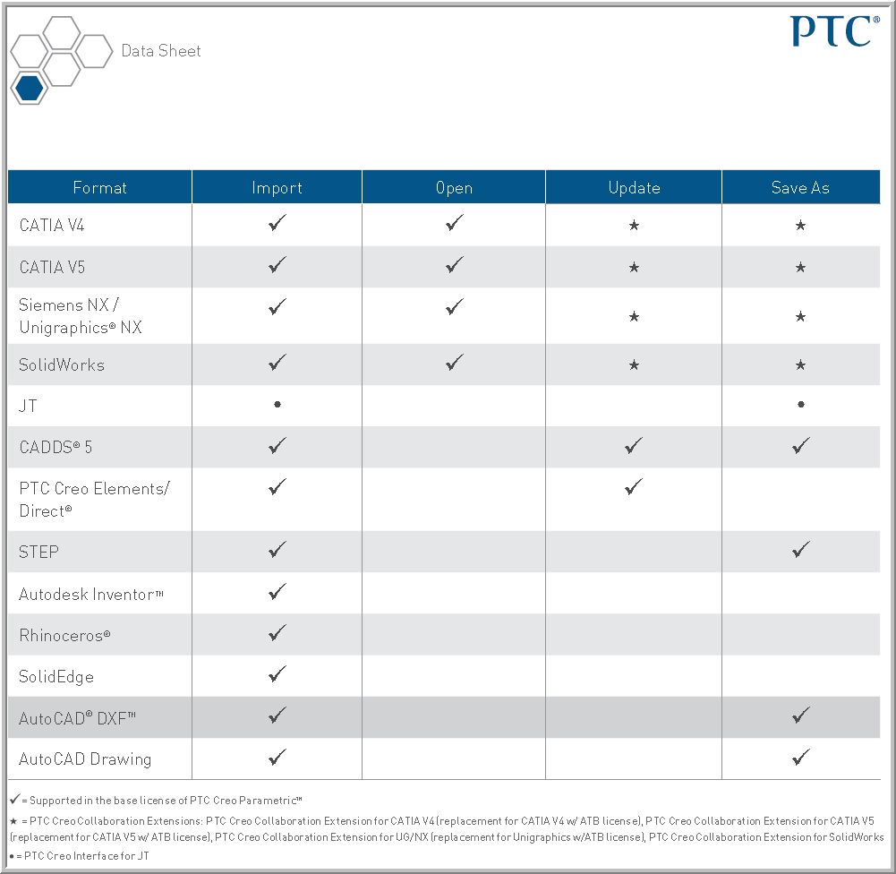

PTC Creo provided the following chart of Creo's capabilities:
According to this chart above, AutoPIPE CONNECT v.10.00.0010 and lower cannot import a model directly from PTC Creo. There seems to be 2 avenues,
1. From Creo save to Soildwoxs model format, open model in Solidworks, save  as PCF file, and import PCF file into AutoPIPE.
2. From Creo save to AutoCAD Drawing model format, open model in AutoCAD, and then perform the process to "Import AutoCAD Coordinates" into AutoPIPE.
