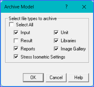

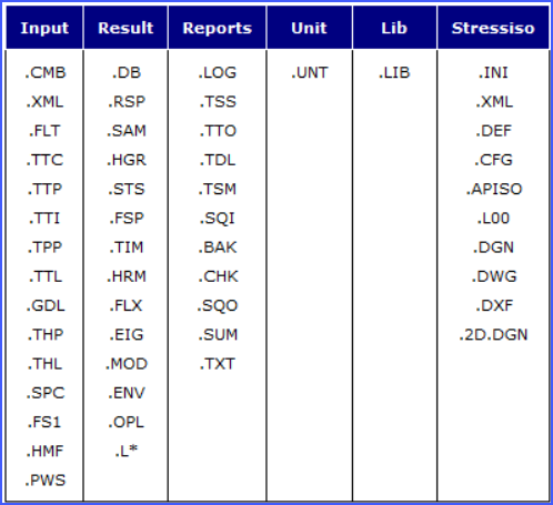

An APC file is really just an archive ZIP file contains files used by AutoPIPE. The following table lists the file extensions included with each 'file type' option available in the Archive Model dialog:

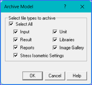

c. Enable features for APC file on the following Dialog, press OK to continue.

4. The archive APC file is too big to email, what can be done?
If the APC file is too large, the file size can be significantly reduced by recreating another APC file and disable the Results check-box.
Again, if the APC file is still to large, again, the file size can be significantly reduced by recreating 3rd APC file, however this time disable both Results & Reports check-boxes as shown below:

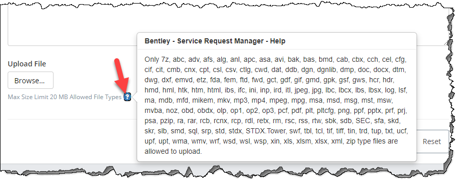

5.  Cannot send APC file in email, why?
If you are unable to send an APC file attachment in an email, contact your IT department to discuss any firewall restrictions on the APC file extension. Typically companies will only allow certain formatted files through their fire walls. You will notice when logging a Service Request, that there is a list of acceptable file types:
Again work with your IT department and email recipients' IT departments explaining what an APC file is (see above) and ask that an APC files be allowed to be sent / received through emails.
As indicated above, Bentley allows an APC file type to be sent through email, this was only possible after our IT department updated our policy to add APC to the list of allowed file extension.
