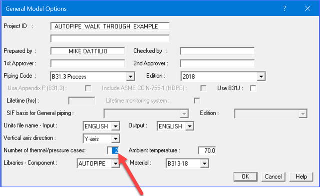

How do I add more Temperature and Pressure Cases into a New / Existing model using AutoPIPE?
Simple, open the General Model Options dialog and increase the "Number of operating load conditions" value as needed.
Note: if one does not know how to open this dialog, use the Command Search feature, enter General to see the command location
Place your cursor in this field and press the keyboard's F1 key to see dedicated information on this field.
General Model Options Dialog
