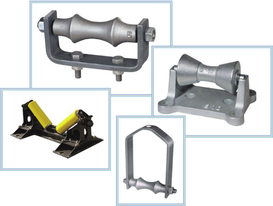

Typically used for support of piping where axial movement due to expansion and contraction often occur. The roller reduces wearing of support or pipe  surfaces that would otherwise be worn away due to direct rubbing of metal surfaces against one another.
Roller supports are available in a many different configurations to meet design criteria. List out the design criteria of your roller support?

In AutoPIPE insert a support, on the support dialog, select the Help button. Here the user will see a chart of all the different type of supports and respective bearing directions the can be used in the program. Using one or more supports together, model the support:
Option #1: Model as a V stop with Large gap up, with small friction factor
Option #2: Model as an Incline with large gap up, with small friction factor
Option #3: Model as a Guide support with the appropriate gaps in all direction and small friction factor
In actuality, roller supports by themselves provide a small amount of lateral restraint due to the shape of the pipe roller. Option #1 or #2 above assumes that the pipe is free to move on the horizontal plane with only friction restricting movement. If using option #3, user is able to set a support gap limiting lateral movement but pipe will be free to move on the horizontal plane with only friction restricting movement until a support gap closes.
Different Types of Supports
