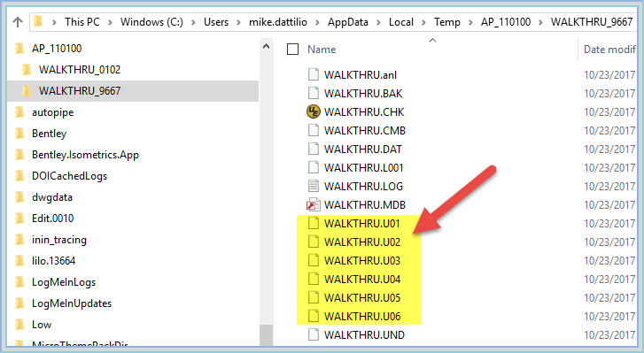

Option #2: Rename Undo files
a. Open folder location where model was stored
b. All Undo files are saved as a U01...U**.
c. Rename one of these files to *.DAT
d. Open with AutoPIPE.

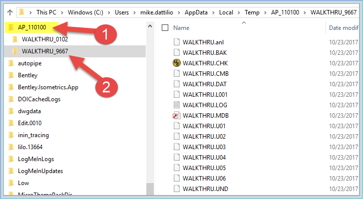

Option #3: Recover files from Temp folder
a. Select Start button
b. In the field  just above the button type in "%temp%", and press keyboard enter / return key.
c. This will display your user profile temp folders, scan down for a folder with the format "AP_..."  (ex. AP_11, AP_09, etc..) and open this folder to view the files within.
Note: This folder contains temp files used by the program. When a file is closed by the program, it will automatically remove these temp files. If AutoPIPE is currently closed, no model is open on your system, these represents instances where AutoPIPE may have been closed incorrectly or system crashed where these files could not have been automatically removed.
d. Search for a folder with the correct system name that was being worked on, and open that folder.
e. If there are files within it, move the entire folder to a safe location (ex.  desktop), and try to open the AutoPIPE DAT model from this new folder location. Otherwise use the steps above to rename any BAK or Uxx files and open them for review.
f. If successful in recovering a file, with it still open in AutoPIPE, save the file to the correct working directory location typically used for your AutoPIPE models.
Note: If AutoPIPE is closed, no model is currently opened, you may delete the AP_xxxx folders from the %temp% location with out concern.

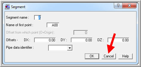

Option #5: Insert the model into a different model

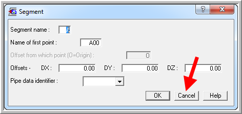

a. Open AutoPIPE and create a new file, be sure to mimic the exact same settings on the "General Model Options" dialog when creating this new file (ex. piping code, edition, number of thermal cases, etc..) and press the OK button.
b. When the model prompts for the first node point, press the "Cancel" button to close the Segment dialog.

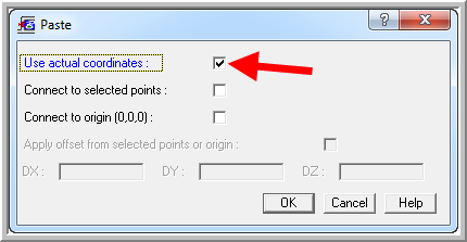

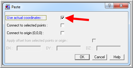

f. A Consistency check is performed, then the Paste dialog is displayed. Select the first option "Use Actual Coordinates:" and press OK button.
