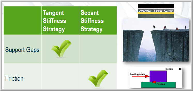

AutoPIPE’s nonlinear analysis engine uses two methods to handle piping models. The tangent stiffness strategy and the secant stiffness strategy which are both used by FEA programs like ANSYS & ABAQUS.
The tangent stiffness strategy handles all the supports with their gaps. The secant stiffness strategy handles friction.

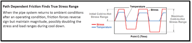

The total load approach (like most pipe stress software uses) doesn’t understand boundary conditions and how the bearing force can change with the direction of the pipe movement which can possibly double the stress and load range.
For example the magnitude of the friction force as the pipe returns to ambient conditions after an operating condition will be the same magnitude but in the reverse direction and this could possibly double the stress and load range.

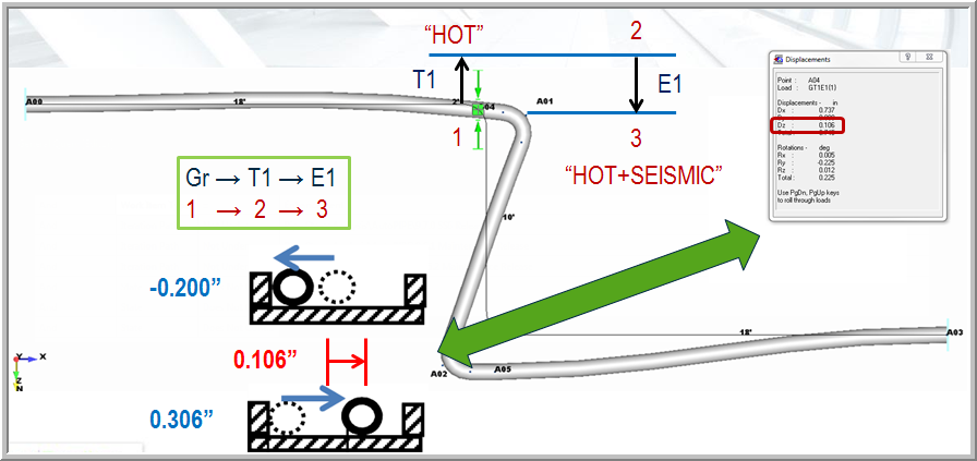

In a nonlinear analysis, the sequence of the loads is important
The following is the default load sequencing in AutoPIPE

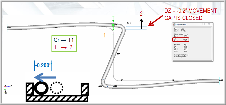

Let’s take a look at the thermal case as it hits the support. This figure shows the pipe movement from the gravity case to the thermal case. As we can see the pipe moves 0.2” in the negative Z direction and hits the support.

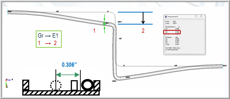

Now we will take a look at the seismic case. This figure shows the pipe movement from the gravity case to the seismic case. As we can see the pipe moves 0.306” in the positive Z direction.
And now we will look at the correct load sequencing load case which shows the pipe starting with gravity, (click) applies thermal case which hits the support gap, (click) then with the earthquake load moves to its final position which is 0.106” in the positive Z direction.
