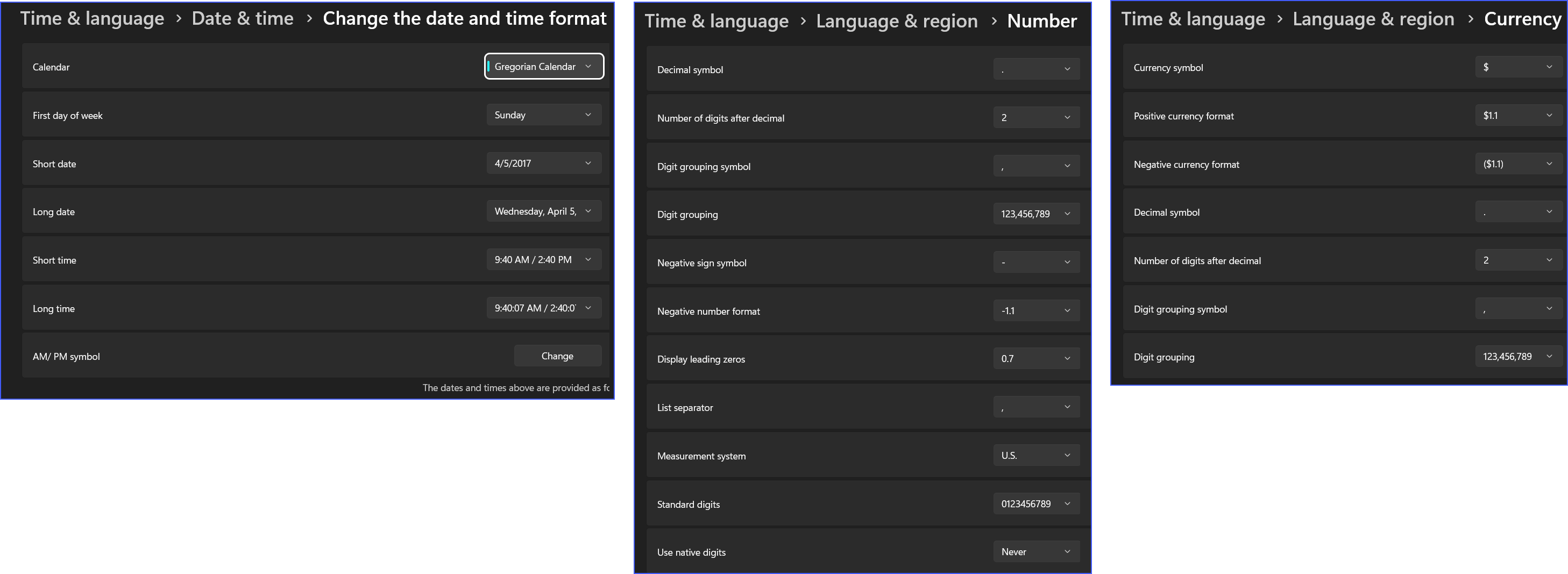

a.  For testing purpose suggest to change all region settings to United Kingdom (English) or US (English), Test to see if AutoPIPE is not behaving correctly
If Yes, the issue is directly related to one or more regional settings when using Country or Region is set to other than English. Try setting Country or region to your area, however match as many regional format values to that when English is specified.
Example:
Country or Region = Germany
Regional Format = Same values used when Country Region = English for all settings under Number, Currency, Time, and Date.
Note, to really narrow the issue down, use an iterative approach, change a few settings and then try to using AutoPIPE. If the problem remains, continue changing a few more settings and try using AutoPIPE again. Continue process until the program runs correctly.

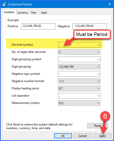

b.  Most importantly Decimal symbol and Number format uses a " . " (period).
 It is really difficult to know if using "." or using "," therefore, suggest to use Window's Magnifier command to confirm setting.
To quickly turn ON Magnifier, press the Windows logo key  + Plus sign (+) .
To turn OFF Magnifier, press the Windows logo key + Esc . 
