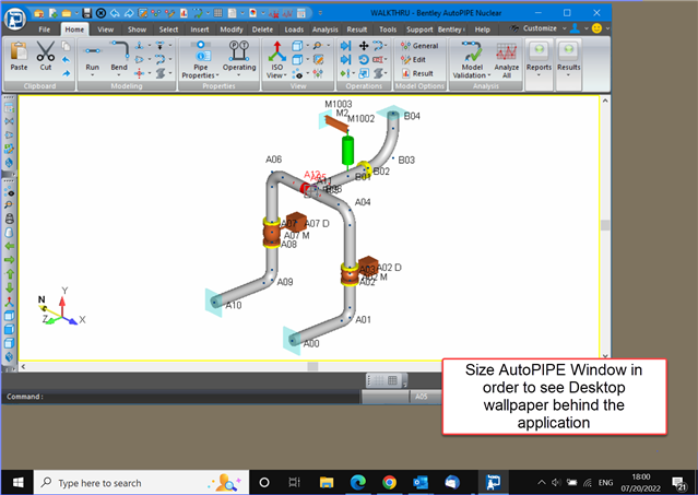

Emergency option, open an AutoPIPE model. Then press keyboard Win+D keys to view the desktop, again select the AutoPIPE icon from the tray so the application window appears on screen. If AutoPIPE application window is NOT set to maximum size, skip to next step. For those with application window set to maximum size, In the top right corner of the application window press the "Restore down" button, and size the window so one can see a portion of the desktop wallpaper.
Place your mouse on the Desktop Wallpaper and Right click the mouse, Select "Display settings", a dialog will appear. For those with multiple monitors, select the display that AutoPIPE is currently on. Now scroll further down the dialog and change the "Display resolution" to the last option at the bottom of the list (typically 800x600), after the screen resolution changes, press the "Revert" button. Now try to turn the input grids On and Off. The Input grids should now appear in view.
