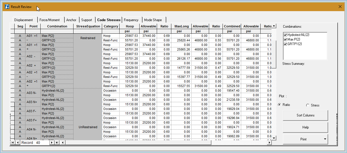

Why are the Stress results for ASME B31.8 0.00 in AutoPIPE output report?
Example:

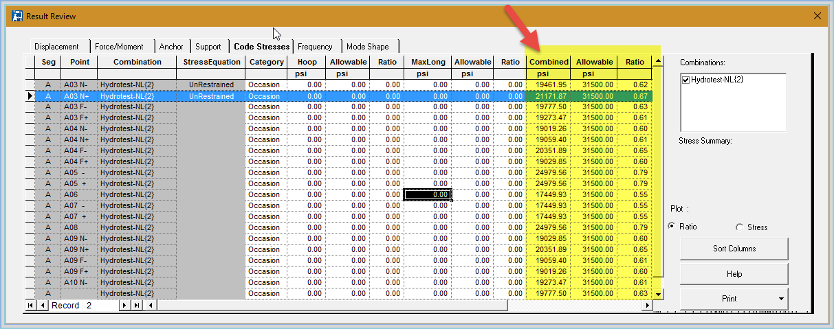

Scroll over to the right in the grids to see the Combined column:

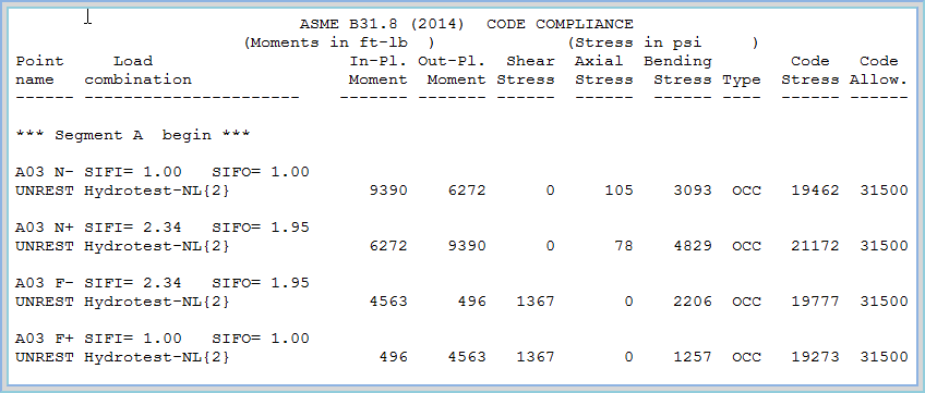

The combined column provides the Hydrotest operating condition stresses results in addition the calculated Allowable and Ratio values.
Same goes for the Output rep

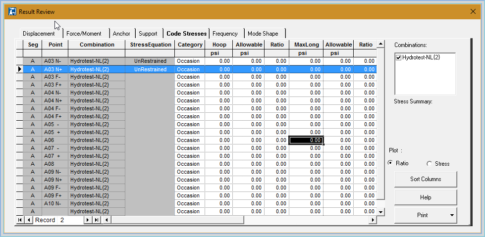

Question: But why are the hoop stress results grid value = 0.00 and only shown for those points where the Piping Stress Equation is set to "Unrestrained"??
Answer:
Please see the following AutoPIPE help section:
Help > Contents> Contents Tab> Reference Information> Code Compliance Calculations> ASME B31.8 - (2014)> Hoop Stress> see note at the bottom of the page,
Copied from help:
"Note: The Hoop stress for restrained piping combinations e.g. GRTP1 can be viewed...."

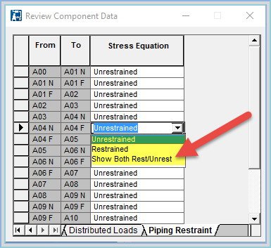

Note: On the Piping Restraint tab of the input grids one can always select which Stress Equation to use or there is an option to print both.
