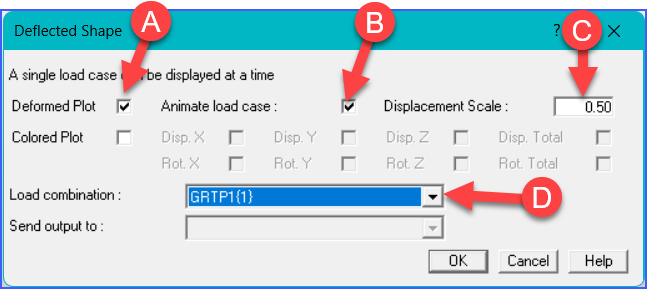

AutoPIPE is able to calculate the displacement of each node point in a model per a specific load case or modal analysis. There is a graphical feature in the program to display the deflection of all these node points simultaneously called the "Deflected Shape". After analyzing a model, select Results> Displacement or Mode Shape, in a moment the following appears:
A: Must enable Deformed Plot option
B. Must enable "animate load case" option
C: Enter a scale factor.
Note: A higher specified scale factor would result in a more exaggerated higher deflection plot.
D. Select dropdown, must choose a load case to animate.
Press Ok button to animate the load case.
The animation represents the movement from the original model to the deflected shape based on the specified loads or mode shape .

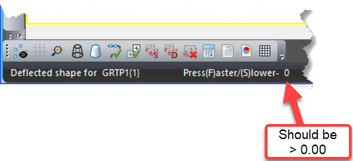

1. Adjust animation speed (values: 0 to 10) see lower left corner of application screen:
***Warning*** if the model is not animating, check all the setting on the previous dialog and confirm animation speed in lower left corner is greater than 0.

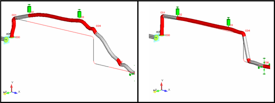

REMEMBER this deflected shape is a exaggeration that can be controlled by Tools> Model Options> Results> Displacement Scale.
Again, from the online help:
This value is used to scale the magnitude of the maximum displacement as it is shown on the screen (or pen plotter dump) in a deflected system shape plot. The default is 0.5 inches (or the equivalent for the current input unit set). However, any value from 0 to 2.0 inches may be specified.
Changing this value will have a dramatic affect on the deflected shape displayed as shown below:
Left: Displacement Scale = 1, Right Displacement Scale = 0.1
Again the displacement shape is an overly exaggerated display, review the actual displacement report for actual values.
