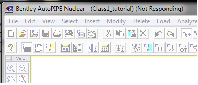

The following text appears in the application bar:
Bentley AutoPIPE (systemname) (Not Responding)

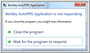

or the following is displayed:
Bentley AutoPIPE Application
Bentley AutoPIPE Application is not responding
if you close the program, you might lose information.
Why is this and What do I do?
The most common reason for this to occur is because the application is trying to process the current command while another command is being issued before the first command has had time to finish being processed by the application.  The 2nd command be initiated by the user or by the application itself.
The application needs additional time to process model that have:
A. large number of node points (>8000 nodes)
B.  Modal analysis with very high cut off frequency
C. Any type of dynamic analysis
D. Copy / Pasting large amounts of data
E. etc..
Depending on the function / analysis being performed, the program needs sufficient time to process.  Pressing additional keyboard keys or menu selection will cause the application to instantly crash. The best course of action is to leave the mouse and keyboard alone and let the application complete the intended process on its own.
After a period of time, the process should be completed and the (Not Responding) message will disappear from the application bar. The user can continue to use the application as intended.
Again, best course of action, give AutoPIPE time to process the initiated commands before pressing more buttons. However, if the dialog message shown above appears for an extended period of time, one of two things has occurred:
1. The application is still processing the command and requires more time
or
2. The application has encountered a problem in the model database and cannot get passed it..
There can be a number of reasons that would cause this to occur. However, the CAE development team is constantly working on error trapping these issues to resolve them automatically. Only course of action is to press the "Close the program" button, afterwards the application will close. Suggest the following:
A. Open a new model with the same General Model Option Settings, and import the exiting model into a new model, this will sometimes filter the database to clear some issues that may have occurred with the previous model.
B. If this does not resolve the issue please log a service request and send in an AutoPIPE APC file for review.
