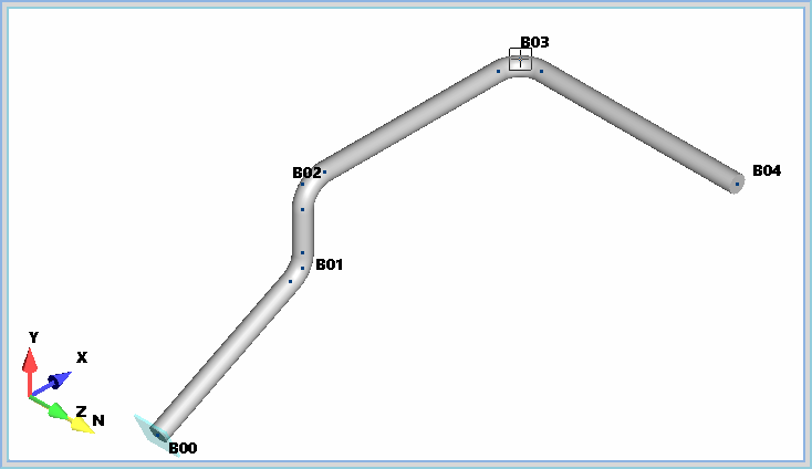

From Model Consistency Check Report:
W726-8: Kink in straight run at following point(s)
B01 63.4 deg
B02 90.0 deg
B03 90.0 deg

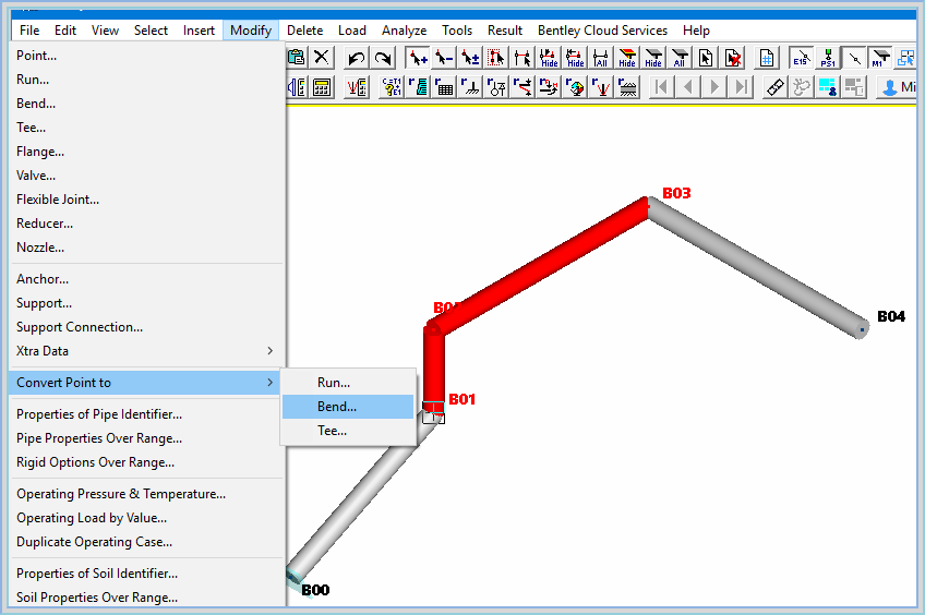

Procedure to change all kinks to bends:
Step 1. Select all node points in the model except the first and last node points.
Step 2. Select Modify> Convert Point to> Bend...

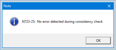

Step 3. Confirm that no kinks exist in Model Consistency Check report:

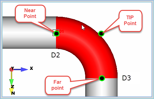

However, IF the survey data only provides coordinate location to the Bend's Near and Far points and not the TIP (shown below), there are 2 options: 1. Update the Excel file before importing 2. Add the TIP after importing into AutoPIPE.

1. Answer these questions: What size pipe is it? what type of bend? Short / Long / 3D/ 5D radius?
With these 2 pieced of information, the TIP (Transition Intercept Point) points can be calculated.
2. Assuming a 12" dia pipe and Long radius bend calculate the TIP point coordinate:
Refer to a publication on elbow dimensions, find that a TIP for the assumed elbow would be 18" along the axis direction for both legs of this bend (Dimension A is sketch below)

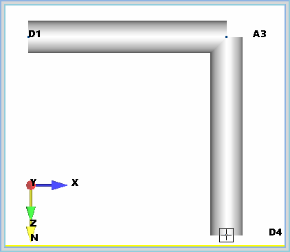

| Point | Global X ft | Global Y ft | Global Z ft |
| D1 | |||
| D2 | 5 | ||
| A3 | 6.5 | ||
| D3 | 6.5 | 1.5 | |
| D4 | 6.5 | 6.5 |

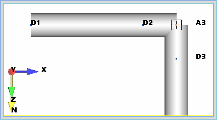

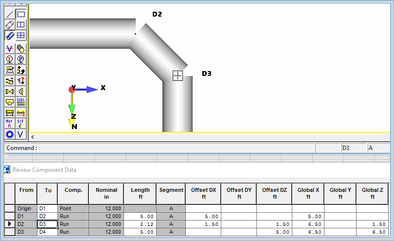

5. Importing this date into AutoPIPE looks like this
6. To make converting kink points to bends easier suggest to remove near and far point coordinates from imported data:
| D1 | |||
| A3 | 6.5 | ||
| D4 | 6.5 | 6.5 |

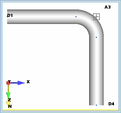

7. Importing this date into AutoPIPE looks like this
8. Use the procedure above to mass convert all kink locations into bends

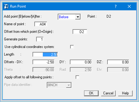

1. Perform Steps #1 and #2 from option #1 above.

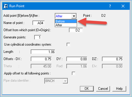

2. Go to bends Near point (ex. D2)
3. insert Run
Notice that the Length and offsets are for the pipe between node points D2 and D3.
Change Add points from After to Before
Notice that the length and offsets are based on the pipe run between D2 to D1.

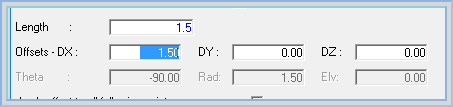

Enter a Length value equal to dimension A in step #1 above (ex. 1.5 ft) and press the keyboard Tab key once.
Notice that the Offset values updated automatically, need to change the sign direction for each non zero value (ex. change -1.5 to 1.5)
Press OK to continue.
4. The following Message may appear,
Warning
W754-1: Sweep angle is 180 degrees
OK
press OK to continue.

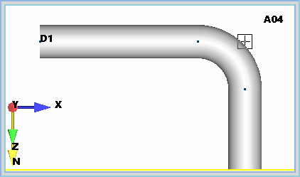

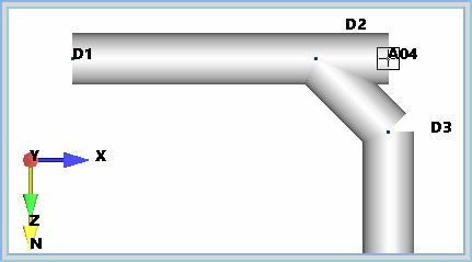

5. The model will look like this now:

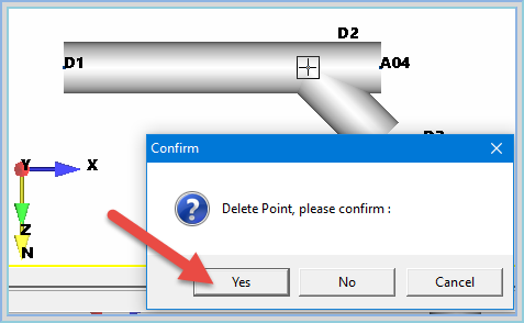

6. Press the Right Arrow key on your keyboard, moving to the next node point (ex. D2). and Delete the node point (ex. D2).
7.Set current node point to TIP point (ex. A04), Using Modify> Convert Point to .... command , convert point to Bend.
8. Optional, delete Far point (ex. D3)
9. Done:
