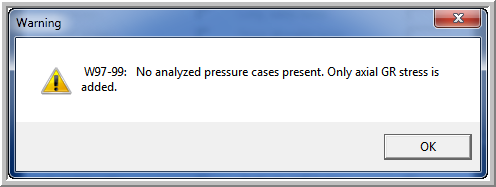

The following message appears in AutoPIPE:
Warning
W97-99: No analyzed pressure cases present. Only axial GR stress is added.
OK
Why and how to avoid it?
As the message indicates that the analysis set(s) does not have an active pressure case.
Avoidance:
Select one of the following options:
a. Turn OFF the following setting:
Tools> Model Options> Results> Include Axial, Pcase in Sustained
or
b. If "Include Axial, Pcase in Sustained"is enabled, then for at least one Static Analysis Set enable the following feature: "Pressure Ext." also known as "Calculate pressure extension cases, e.g. P1, P2, etc". This feature is located under Load> Static Analysis Set> .
