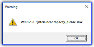

The following appears:
Warning
W961-12:  System near capacity, please save
OK
why?
AutoPIPE does not use all of the systems resources. Internally it is limited to a percentage of the total system resource available. This message is displayed when the program allocated system resources are almost depleted or when model data in the DAT file reaches around 37MB.
Example: As of Jan 2025, when opening a AutoPIPE model, the database can only use 10 meg worth of system memory. The above message is displayed when the database requirements are getting close to 10 meg of memory consumption.
After encountering this message, the application may experience reduced performance with large models or demonstrate other issues associated with the near depletion of allocated resources (ex. a. sluggish graphics regeneration, b. slow panning or zooming, c. prolonged analysis times, d. the appearance of this warning message, etc..).
