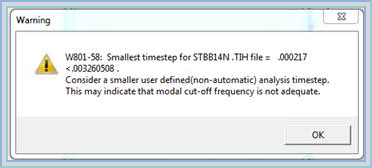

The following warning appears when running a Time History analysis:
Warning
W801-58:  Smallest timestep for TPCE07  .TIH file =   .000617 <.000625002 .
Consider a smaller user defined(non-automatic) analysis timestep.
This may indicate that modal cut-off frequency is not adequate.
OK
 How to resolve this issue?

In this example, the analysis duration was found to be, Analysis time step = 0.000625 sec.
From the warning dialog message above, TPCE07  .TIH file =   .000617 <.000625002.
TPC = name of fluid transient
E07 = node point where warning is occurring
TIH = file extension name
0.000617 = time calculated from the TIH file
Open the THL file mentioned above (ex. TPC.THL), search for the node point mentioned in the warning (ex. E07), The following was found:
Existing TPA CONVEYING Line W1004466
    3     TIH FILE      SCALE      DX        DY        DZ     TIME(sec)
B08       TPCB08        1.000    -0.707    -0.707     0.000   0.079889
E04 F     TPCE04F       1.000     0.000    -1.000     0.000   0.081416
E07       TPCE07        1.000     0.000    -1.000     0.000   0.082444
 TIME AT END OF FLUID TRANSIENT :   0.083061 sec
Calculte duration from node point to node point to end of fluid transient:
B08 to B04 = 0.081416 - 0.079889 = 0.001527 sec
B04 to E07 = 0.082444 - 0.081416 = 0.001028 sec
E07 to End = 0.083061 - 0.082444 = 0.000617 sec
Compare results: Actual value in transient vs Value automatically calculated
0.000617 < 0.000625 was found to be true.
Fix as recommended in warning message, open Dynamic Analysis dialog screen, select the Time History tab> change the following:
Analysis Steps (s) = from Automatic to value smaller than mentioned in warning message, ex. 0.00061 sec
Output Steps (s) =  from Automatic to value smaller than mentioned in warning message, ex. 0.00061 sec
Run the analysis, remember it may take a bit of time to process, the application may appear to have stopped,  just leave the mouse and keyboard alone until analysis is finished. The Warning message should not have appeared now. continue review with analysis results.
