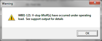

The following occurs when I run an analysis:
Warning
 W801-121: V-stop liftoff(s) have occurred under operating
 load.  See support output for details
OK
what should I do?
This warning occurs when pipe moves in a +ve upward direction off of the support (AKA lift-off has occurred). Another words in the Forces and Moments report, for any combination where the total vertical +ve force is greater than or equal to the Gravity (-ve) force, lift-off has occurred.
