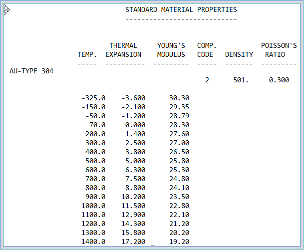

1. Create a Library MATL table Scan.

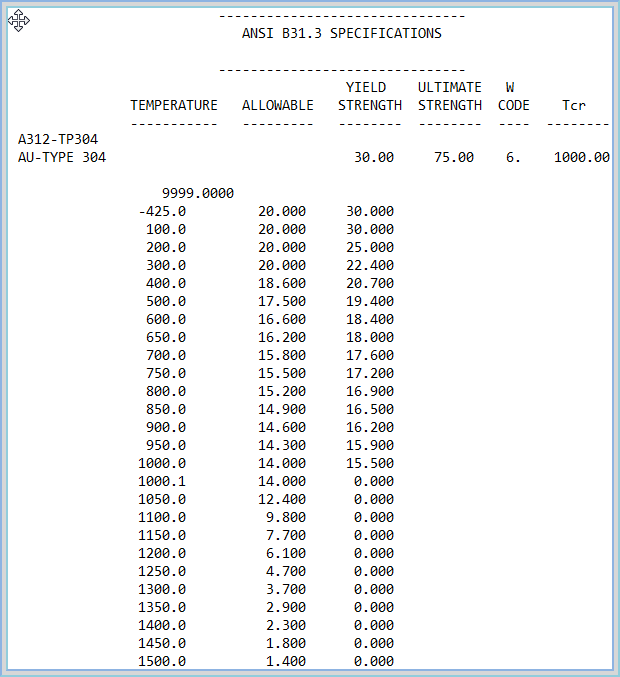

2. Create a Library SPEC table scan

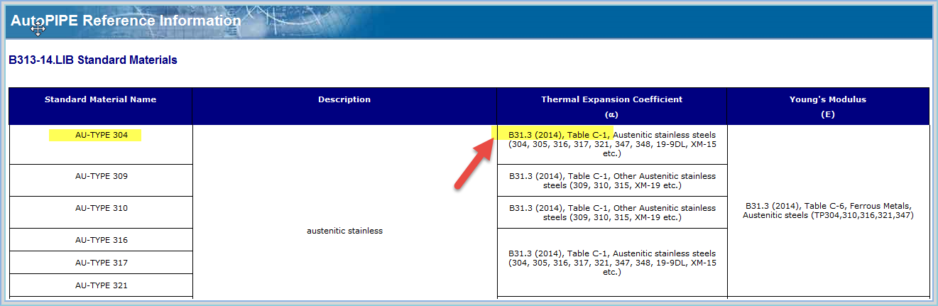

Please see the following AutoPIPE help section:
Help > Contents> Contents Tab> Reference Information> Libraries> Standard Pipe Materials> B313-14.LIB Standard Materials

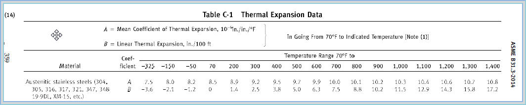

4. Review the CODE reference:
3. Review the scan information.
a. Noticed that -420 deg F is with in the MATL table data
b. Noticed that -420 deg F is NOT within  the  SPEC table data.
c. Notice the material code reference starts at -325 deg F (exactly as shown in AutoPIPE Library)
Therefore the  W727-2:warning above is displayed. However, data not with in the table is automatically linearly interpolated and used by the program. Again the user has the option to suppress these warnings at their discretion.
