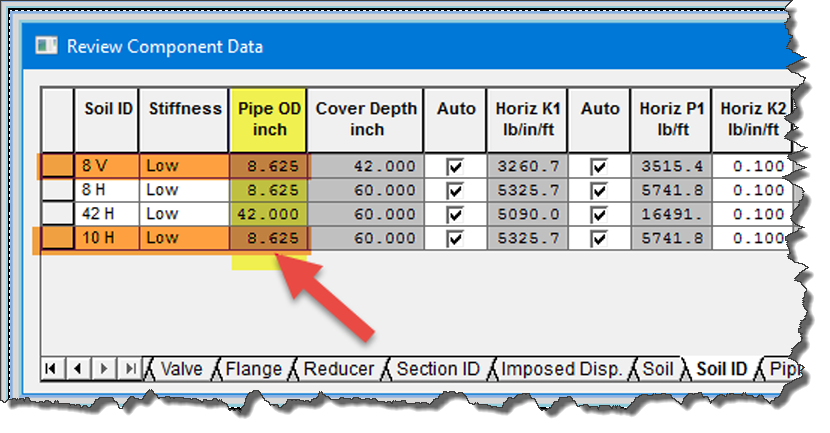

 As indicated the soil calculations were performed using a specific size pipe. The indicated node point may not be the same size.
Example:
Message was displayed
* * * W A R N I N G - MODEL * * *
W2164-30: Outside diameter does not match with soil properties at following point(s)

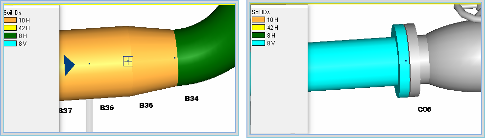

B35, C05

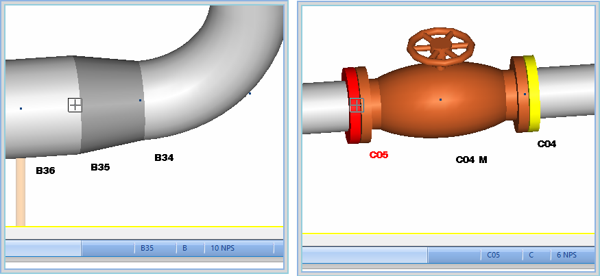

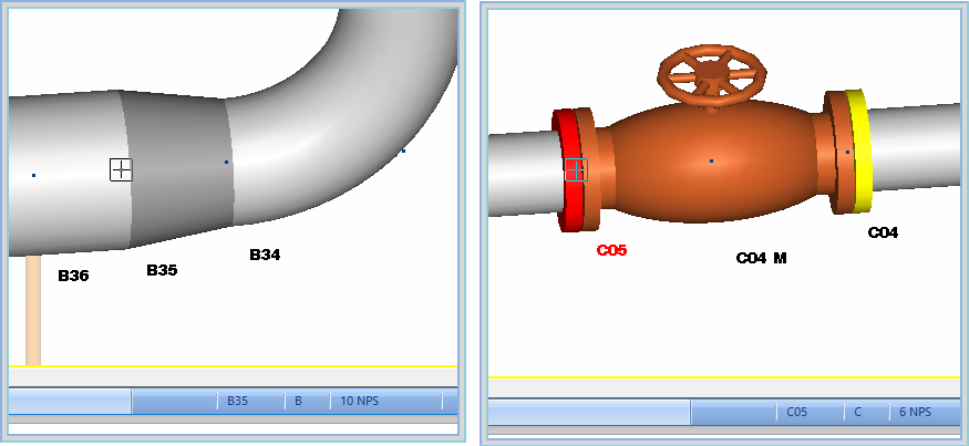

Review node point location:
Review the soil properties and pipe properties for each location

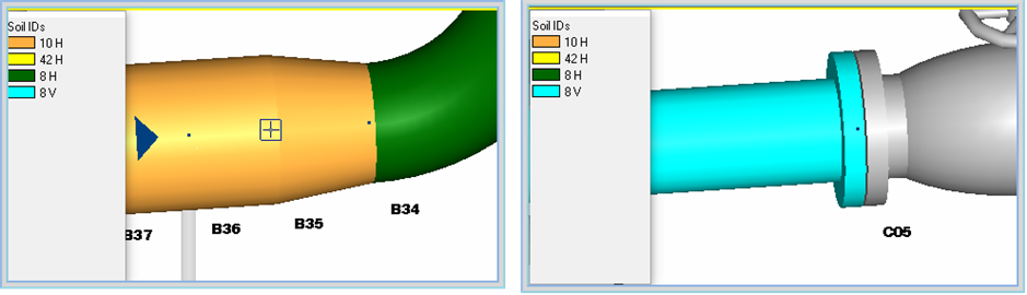

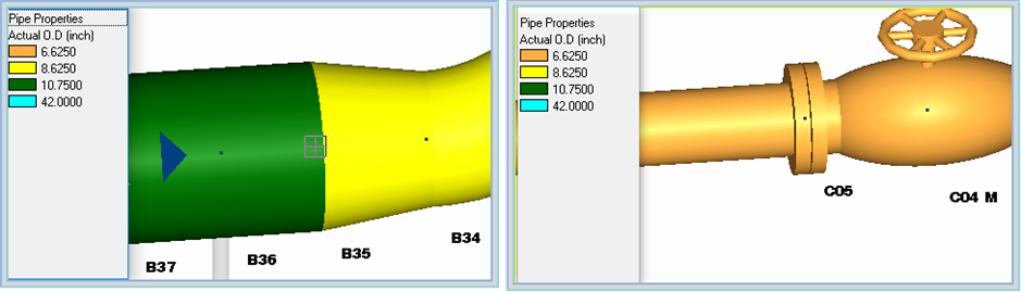

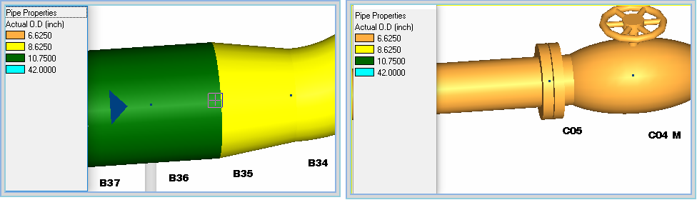

Node B35:
One side of this node point was actually 10.75" dia and the other side was 8.625" dia

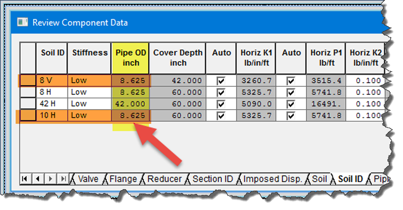

However the soil properties were calculated based on Soil id = 10H where pipe OD = 8.625" dia.
Node C05:
On both sides of the node point pipe OD actually = 6.625"
However the soil properties were calculated based on Soil id = 8V where pipe OD = 8.625".
This warning will only appear when there are discrepancies between soil data and pipe data.
Workaround:
Soil OD and Pipe OD must match or this warning will appear. When warning appears, review the node points mentioned in the message and determin which value is right / wrong. Update the incorrect value.
There may come a modeling scenario where the warning will continue to show. After a through review of the offending node points and determining that all values were found to be correct, accept the the warning will continue to appear in the consistency check report and ignore it.
